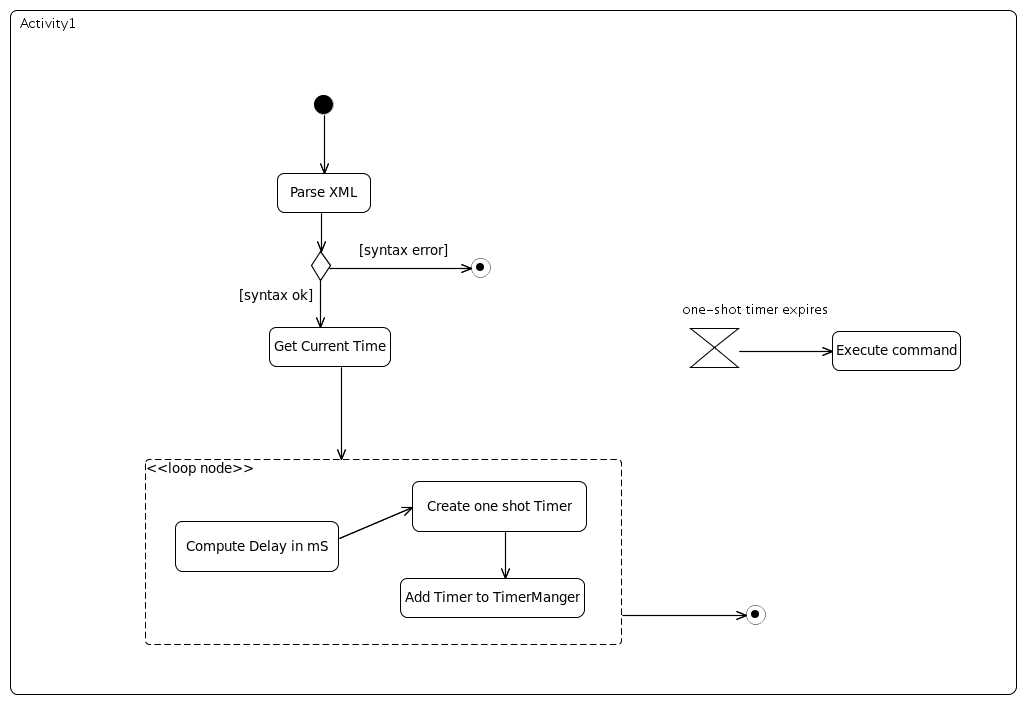

I'm still confused. I have attached a copy of my activity diagram which has the following error:
the opposite features 'activity" of <loop Node> for each command' and node of '<Activity> Activity 1 do not reference each other.
I am at a comlete loss. I can attache the model if that helps as well.

Re: Understanding Validation errors [message #1274385 is a reply to message #1273979] Fri, 21 March 2014 07:55 Go to previous messageGo to next message
By all means, attach your model.
You should see in the XMI that either
(a) the "for each command" LoopNode element has an 'activity 'attribute
referencing the ID of the "Activity 1" Activity element but "Activity
1" does not have a 'node' attribute or element referencing the ID of
"for each command", or
(b) the "Activity 1" Activity element has a node attribute or element
referencing the ID of the "for each command" LoopNode but "for each
command" does not have an 'activity' attribute referencing "Activity 1"
In the UML metamodel, ActivityNode::activity and Activity::node are two
navigable ends of an association, so they are "opposites". In a valid
model, every activity and node that are thus associated must reference
one another. This is evidently not the case in your model.
HTH,
Christian

Re: Understanding Validation errors [message #1274631 is a reply to message #1274560] Fri, 21 March 2014 15:09 Go to previous messageGo to next message
The attached tar.gz file was was corrupt and I couldn't get the *.uml
file out of it.
But, I reproduced your problem in a minimal activity model of my own.
This is a bug in the Eclipse UML implementation:
https://bugs.eclipse.org/bugs/show_bug.cgi?id=430907
The implementation of these association ends in the UML metamodel is broken.
You can work around this, for now, by explicitly adding the LoopNode to
your Activity's 'node' property using the Advanced tab of the
Properties view. Click the "..." button in the Node property and add
your LoopNode from the left.
The Papyrus diagram editor created the LoopNode in the Activity::group
feature (not Activity::node), which I think makes perfectly good sense
because a LoopNode is a group (which is a more specific concept than a
node). But the UML implementation needs to make sure that
Activity::node is updated, too, as the opposite of the
ActivityNode::activity feature.
HTH,
Christian

Re: Understanding Validation errors [message #1274636 is a reply to message #1274631] Fri, 21 March 2014 15:17 Go to previous messageGo to next message
Christian,
That's strange. When I download the file from the forum posting, it opens up fine.
But that doesn't matter. Adding the node using the advanced tab worked like a charm.
Now, if I can figure out this expansion node problem (http://www.eclipse.org/forums/index.php/t/673814/) I'll be a happy camper. Do you have any experience with expansion nodes and expansion regions?
