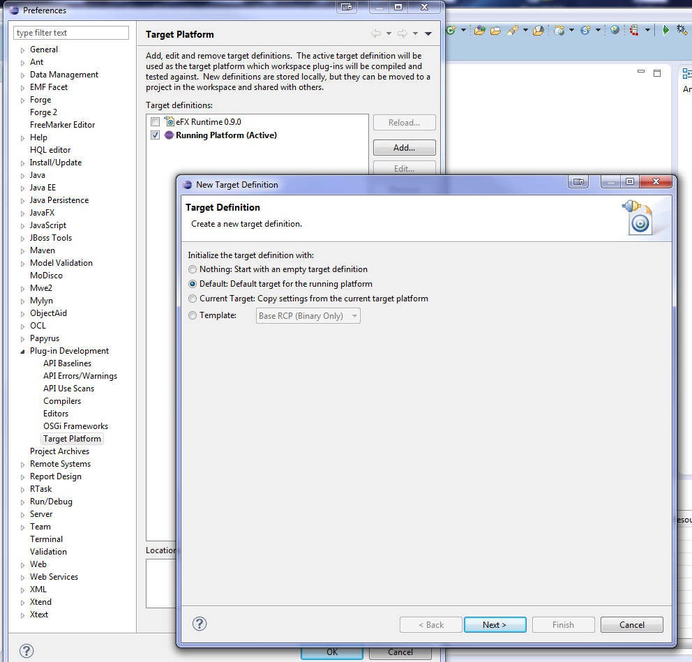

Re: eFX Tutorial 2 gives error results [message #1279518 is a reply to message #1279505] Fri, 28 March 2014 17:47 Go to previous messageGo to next message
Right your screenshot looks like you used "Nothing: Start with empty
target" which wrong.
You need to use "Default: Default target for the running platform" which
will give you as the initial entry "${eclipse_home}" and then you add
the p2 site.
Tom

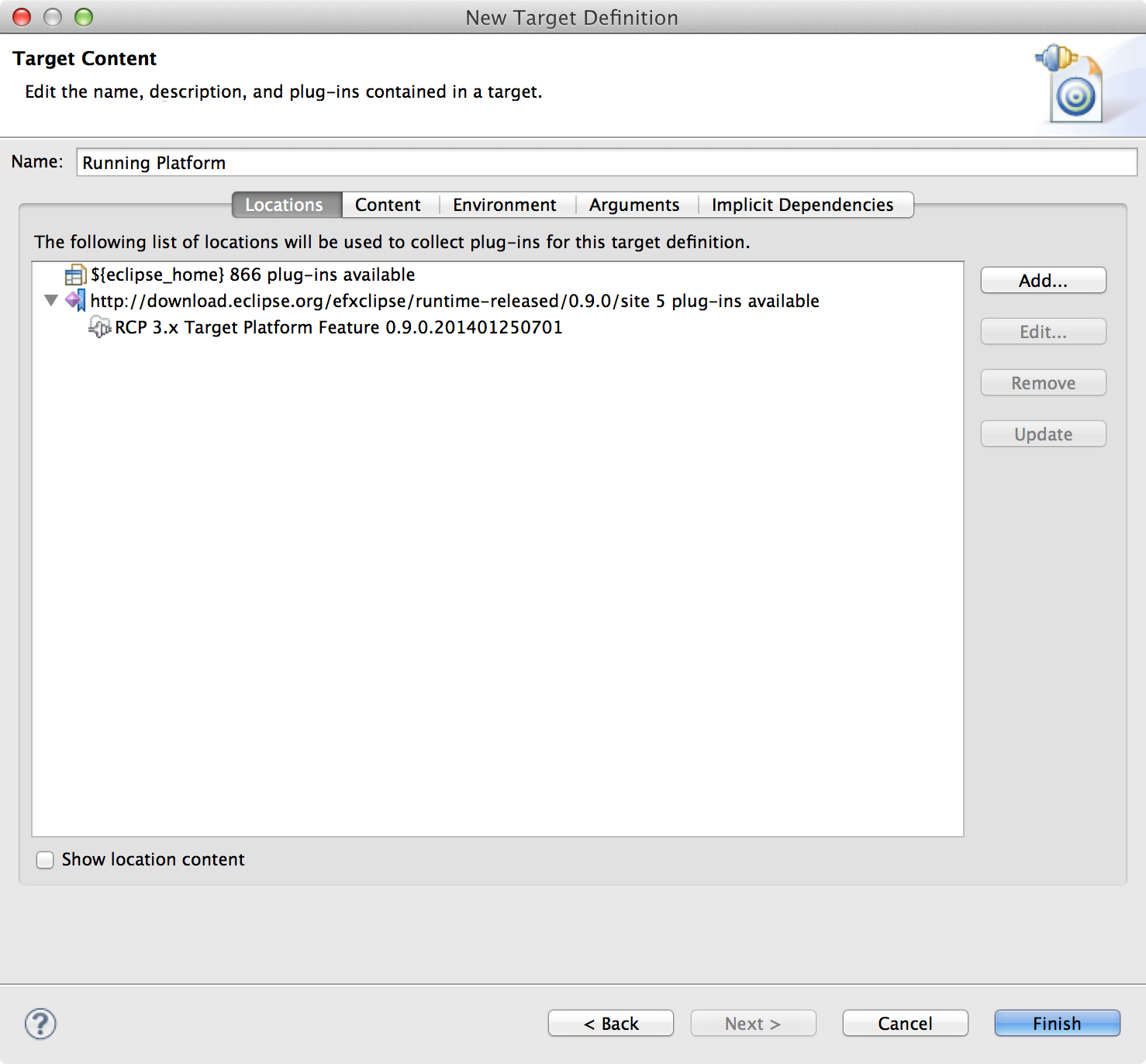

Re: eFX Tutorial 2 gives error results [message #1279519 is a reply to message #1279518] Fri, 28 March 2014 17:49 Go to previous messageGo to next message
this is how it should look like

Re: eFX Tutorial 2 gives error results [message #1279548 is a reply to message #1279519] Fri, 28 March 2014 18:57 Go to previous messageGo to next message
I'm sure I used "Default: Default target for the running platform"
When I finished, I was left with two target platforms named "Running Platform". Is that correct ? I now wonder which one I actually activated.
Did you intend that I should be instead editing my default running platform ?
If I do that, the generated project has no errors.
Attached is the html to describe the changes to step1 of the tutorial if you intended to edit the default target platform.
[Updated on: Fri, 28 March 2014 18:59] by Moderator
Re: eFX Tutorial 2 gives error results [message #1279796 is a reply to message #1279548] Sat, 29 March 2014 04:37 Go to previous messageGo to next message
No i don't not really meant that you modify the current one but add a
new one. You could haven given it a different name.
Yes and the you should enable the newly added one.
No but the result is the same, it now harder for you to get back into
the default state but probably that's ok.
I reworded the wiki to make my intend clearer.
Tom
