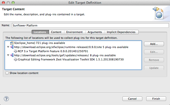

2. Rolling my own 4.3.2 using the following p2 update sites:
For all I create a new Target Platform in a new workspace that grabs the e(fx)clipse 3.x runtime from:
index.php/fa/17740/0/

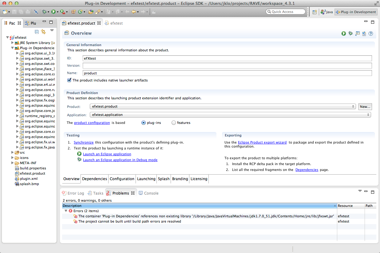

After creating the Target Platform and activating, I'm restarting the workbench for good measure, then for testing, I'm just creating a new "Plug-in Project" using the "JavaFX Eclipse 3.x RCP" just to create a "Hello World" app. Once doing this the sample project has an error which I'm not able to resolve - and have no idea where to start.
index.php/fa/17739/0/
Note the error:
The container 'Plug-in Dependencies' references non existing library '/Library/Java/JavaVirtualMachines/jdk1.7.0_51.jdk/Contents/Home/jre/lib/jfxswt.jar'
So I'm at my wit's end on this. No manner of uninstalling/installing e(fx)clipse seems to work. Am I doing something wrong? Am I missing some step? I'd really like to make some headway on this.

File a bug and I'll try to look at it immediately!
Tom

Bug reported here: https://bugs.eclipse.org/bugs/show_bug.cgi?id=430431
