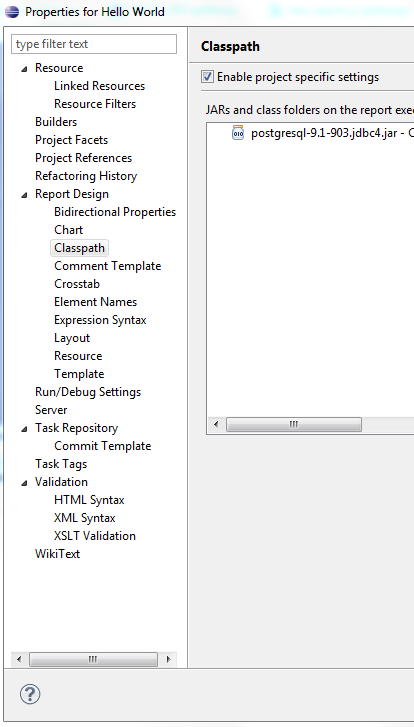

1) Window >> Preferences >> Report Design >> Class Path
there I've added my driver. But I haven't understood how can I use this library
2) Choose the report, in the Property Editor choose Resources, add file there. The same: haven't understood how can I use this library
3) Select Project >> Properties >> Class Path, there I've added my driver
4) Simple add a jar file to the project folder also gives nothing Razz

But there is no Java Build Path in the menu. There is Class Path, but when I add an external Jar it changes nothing.
