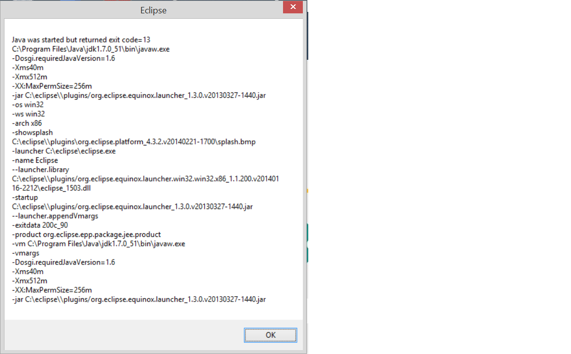

I need some help, what is supossed to do when this error 13 appears.
thanks
  • Attachment: Error13.png

If I had to guess, you're on a 64-bit Windows system with a 64-bit Java but only a 32-bit Eclipse. Java and Eclipse have to match, and Eclipse is probably the easier one to change.
