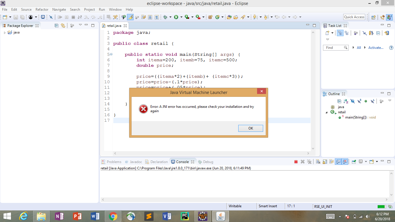

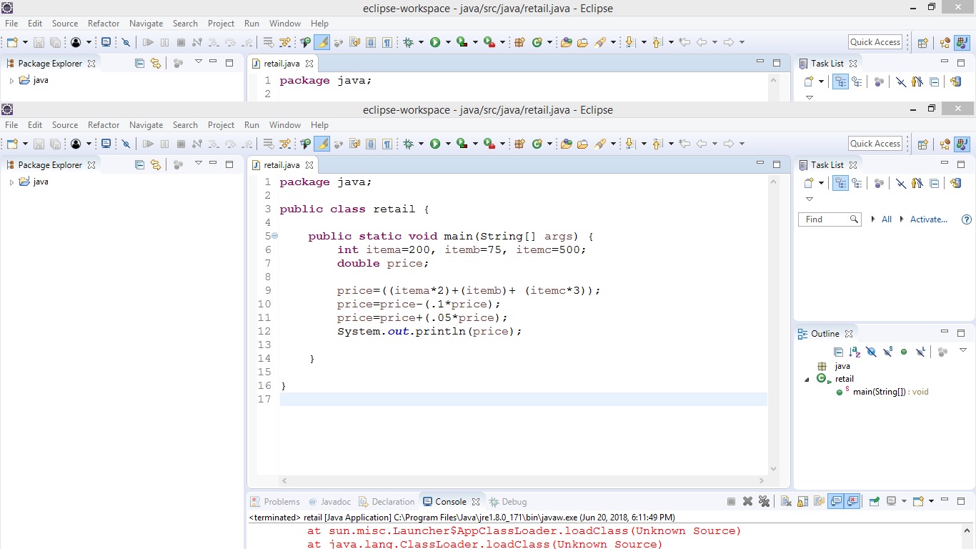

Hi, I run eclipse but receiving the following code:
at sun.misc.Launcher$AppClassLoader.loadClass(Unknown Source)
at sun.launcher.LauncherHelper.checkAndLoadMain(Unknown Source)
Can you please help?
  • Attachment: 2.jpg
    (Size: 216.28KB, Downloaded 201 times)
  • Attachment: 1.png
    (Size: 163.29KB, Downloaded 190 times)
Re: How to execute my application from command line [message #1790991 is a reply to message #1790978] Thu, 21 June 2018 02:03 Go to previous messageGo to next message
You are not allowed to put new Types in the "java" package. Use a different package name.
Re: How to execute my application from command line [message #1791007 is a reply to message #1790991] Thu, 21 June 2018 06:54 Go to previous messageGo to next message
What new types? I dont get it. I did not put in any new types. I just click next next to install eclipse. The ony thing i added is the path in the environment variables
Re: How to execute my application from command line [message #1791106 is a reply to message #1791007] Sat, 23 June 2018 01:10 Go to previous messageGo to next message
Your class says it's in the package "java". Don't do that.
Re: How to execute my application from command line [message #1791108 is a reply to message #1791106] Sat, 23 June 2018 06:06 Go to previous messageGo to next message
Even i deleted it, it still does not work, please check the list lf error messgae
Re: How to execute my application from command line [message #1791112 is a reply to message #1791108] Sat, 23 June 2018 10:17 Go to previous message
If you deleted it, what do you have left? Show a picture of the open source file and the fully expanded tree in the Package Explorer.
