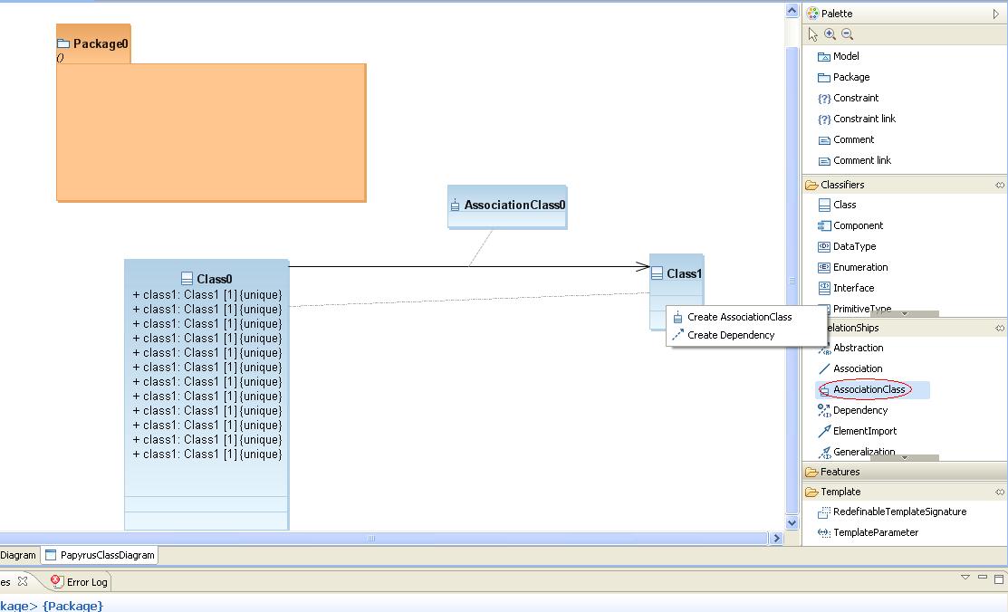

I have added a new mapping for a link. I generate the code. A new button
appear in the palette. When I choose this palette element and then I click
on the diagram, a popup appears in order to choose between two elements.
I dont know why I have this behavior. This is a problem of visual ID?
I have attached the screenshot of the the popup.
Patrick

Are you using two linkMappings for the same domain metaElement? Have your
domain metaElements a generalization relation?
If it is so, I think it could be working bad because the linkmapping needs
a constraint (if your links are typed based links).
Cheers!
