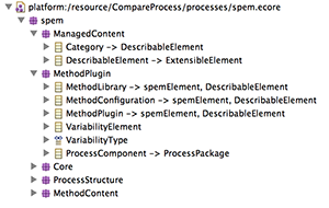

but the 'SpemPackage' cannot be resolved to a type. Correct me if I'm wrong, but do I have to extend an EPackage for each of my subpackages?
My metamodel is structured as it follows: index.php/fa/17724/0/
