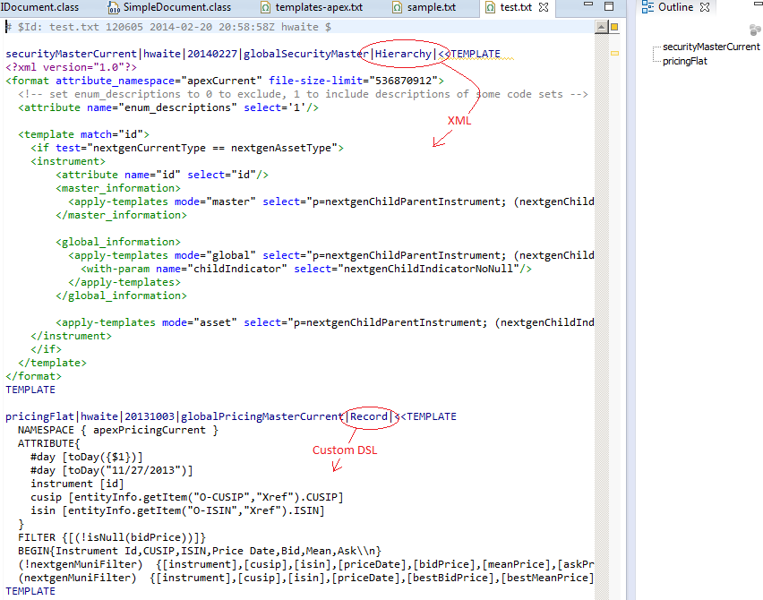

I'm just starting out with XText and don't yet know whether it's the right tool for the job. I read through the grammar documentation and it's unclear whether desired syntax is supported. My input text looks something like the following:

The attached image shows my first attempt at an Eclipse plugin built from scratch. Would love to do this with XText as things should be much cleaner that way.

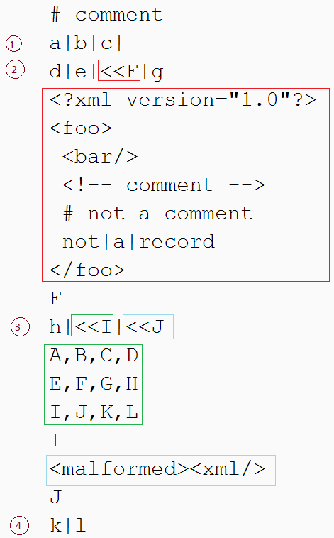

Thanks for your response. Up to now, I've been using nested, custom RuleBasedScanner implementations for tokenization. It's reasonably straightforward to divide document into records, then break records up into columns plus attendant HERE values and then deal with nested grammars as necessary. Unfortunately, all the back and forth evaluation is quite inefficient. Also, hand-spun approach forfeits all of the features that XText provides for free (e.g. content assist, code outline, etc).
It sounds like an XText solution may be marginally cleaner but that there will be some learning curve to deal with. I'll continue to evaluate my options of "build in XText", "build from scratch" and "pay someone else to do it." Your advice is a good start. For future consumers of this thread, I include an image clarifying how my original example should be parsed. If/When you end up supporting heredoc in Geppetto, I encourage you to resurrect thread with any new advice. If I'm able to devise an XText-based solution, I'll plan on doing the same.
