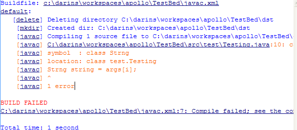

It appears that eclipse doesn't allow me to go to the line of the next
build error, if I use ant, is that right? I can go to the line in the
build.xml file, but that doesn't help me when the error is in a java
file.
Re: ant build, go to line of error [message #207733 is a reply to message #207716] Thu, 23 June 2005 16:33 Go to previous messageGo to next message
This would be incorrect on the latest 3.1 builds...attached picture shows
the linkage for a simple test build
Clicking on the link for the Testing.java compile error will take you to
line 10 in that file.
What build are you using?
Darins

I was using 3.0, I get the same result with 3.1 RC2, but it's actually
only errors from checkstyle that are not being clickable. I see now
that something like a syntax error is clickable. It would be nice if
variations on filename:line were matched in the console output, and
made clickable.

Please log a bug report against Platform Ant with full details so we can
consider this enhancement for post 3.1
Darins
