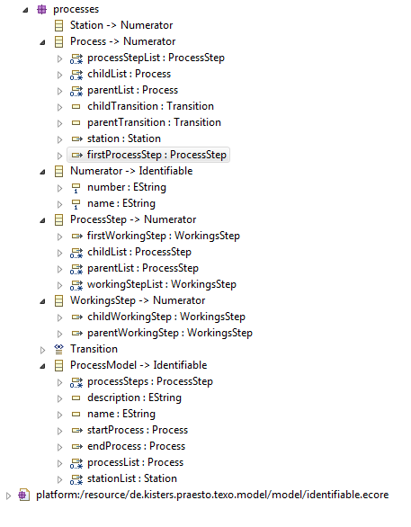

i am developing a small RCP based process modeling tool with texo.
The business model can be seen in the attached image.
Root Object is ProcessModel.
In ProcessModel processList and processSteps are modeled as containments.
The other links between Process <-> Process, Process <-> FirstProcessStep and Processtep <-> Processtep respectivly relevant child/parent Lists are modeled as references.
However, if i persist a ProcessModel everything works fine for Processes.
Processsteps are also persisted but no child/parent relations between Processsteps are stored in the database.

Hi Peter,
Can you check that indeed the child and parent ereferences have unique/different db columns to store the foreign key?
Sometimes different eattributes/ereferences end up in the same column because of name clashes and the behavior you see
can occur.
Can you post the java code of Processstep?
gr. Martin

Hi Martin,
and thank you for your prompt reply.
I checked the child and parent ereferences. I think they are ok, but to be safe i send you the orm.annotationmodel.
Here is the code for ProcessStep:

        <eAttribute href="platform:/resource/de.processtool/model/processes.ecore#//Numerator/number"/>
        <eAttributeAnnotations xsi:type="ormannotations:EAttributeORMAnnotation">
          <basic name="number" optional="false"/>
        </eAttributeAnnotations>
      </annotatedEStructuralFeatures>
      <annotatedEStructuralFeatures xsi:type="annotationsmodel:AnnotatedEAttribute">
        <eAttribute href="platform:/resource/de.processtool/model/processes.ecore#//Numerator/name"/>
          <basic name="name" optional="false"/>
    </annotatedEClassifiers>
    <annotatedEClassifiers xsi:type="annotationsmodel:AnnotatedEClass">
      <eClass href="platform:/resource/de.processtool/model/processes.ecore#//Process"/>
      <eClassAnnotations xsi:type="ormannotations:EClassORMAnnotation">
        <entity class="de.kisters.praesto.texo.processes.Process" name="processes_Process">
          <table name="processes_Process"/>
        </entity>
        <inheritance strategy="TABLE_PER_CLASS"/>
      </eClassAnnotations>
        <eAttribute href="platform:/resource/de.processtool/model/processes.ecore#//Process/childTransition"/>
          <basic enumerated="STRING" name="childTransition"/>
        <eAttribute href="platform:/resource/de.processtool/model/processes.ecore#//Process/parentTransition"/>
          <basic enumerated="STRING" name="parentTransition"/>
      <annotatedEStructuralFeatures xsi:type="annotationsmodel:AnnotatedEReference">
        <eReference href="platform:/resource/de.processtool/model/processes.ecore#//Process/station"/>
        <eReferenceAnnotations xsi:type="ormannotations:EReferenceORMAnnotation">
          <manyToOne name="station" optional="true">
            <cascade>
              <cascadePersist/>
              <cascadeMerge/>
              <cascadeRefresh/>
            </cascade>
          </manyToOne>
        </eReferenceAnnotations>
        <eReference href="platform:/resource/de.processtool/model/processes.ecore#//Process/childList"/>
          <manyToMany name="childList">
            <joinTable name="processes_Process_Child"/>
            <cascade>
              <cascadePersist/>
              <cascadeMerge/>
              <cascadeRefresh/>
            </cascade>
          </manyToMany>
        <eReference href="platform:/resource/de.processtool/model/processes.ecore#//Process/parentList"/>
          <manyToMany name="parentList">
            <joinTable name="processes_Process_Parent"/>
            <cascade>
              <cascadePersist/>
              <cascadeMerge/>
              <cascadeRefresh/>
            </cascade>
          </manyToMany>
        <eReference href="platform:/resource/de.processtool/model/processes.ecore#//Process/firstProcessStep"/>
          <manyToOne name="firstProcessStep">
            <cascade>
              <cascadePersist/>
              <cascadeMerge/>
              <cascadeRefresh/>
            </cascade>
          </manyToOne>
        <eReference href="platform:/resource/de.processtool/model/processes.ecore#//Process/processStepList"/>
          <manyToMany name="processStepList">
            <cascade>
              <cascadePersist/>
              <cascadeMerge/>
              <cascadeRefresh/>
            </cascade>
          </manyToMany>
    <annotatedEClassifiers xsi:type="annotationsmodel:AnnotatedEEnum">
      <eEnum href="platform:/resource/de.processtool/model/processes.ecore#//Transition"/>
      <eEnumAnnotations xsi:type="ormannotations:EEnumORMAnnotation"/>
      <annotatedEEnumLiterals>
        <eEnumLiteral href="platform:/resource/de.processtool/model/processes.ecore#//Transition/MANUALLY"/>
      </annotatedEEnumLiterals>
        <eEnumLiteral href="platform:/resource/de.processtool/model/processes.ecore#//Transition/MECHANICALLY"/>
      <eClass href="platform:/resource/de.processtool/model/processes.ecore#//ProcessStep"/>
        <entity class="de.kisters.praesto.texo.processes.ProcessStep" name="processes_ProcessStep">
          <table name="processes_ProcessStep"/>
        </entity>
        <eReference href="platform:/resource/de.processtool/model/processes.ecore#//ProcessStep/firstWorkingStep"/>
          <manyToOne name="firstWorkingStep" optional="true">
            <cascade>
              <cascadePersist/>
              <cascadeMerge/>
              <cascadeRefresh/>
            </cascade>
          </manyToOne>
        <eReference href="platform:/resource/de.processtool/model/processes.ecore#//ProcessStep/workingStepList"/>
          <oneToMany name="workingStepList">
            <cascade>
              <cascadeAll/>
            </cascade>
          </oneToMany>
        <eReference href="platform:/resource/de.processtool/model/processes.ecore#//ProcessStep/childList"/>
            <joinTable name="processes_ProcessStep_Child"/>
            <cascade>
              <cascadePersist/>
              <cascadeMerge/>
              <cascadeRefresh/>
            </cascade>
          </manyToMany>
        <eReference href="platform:/resource/de.processtool/model/processes.ecore#//ProcessStep/parentList"/>
            <joinTable name="processes_ProcessStep_Parent"/>
            <cascade>
              <cascadePersist/>
              <cascadeMerge/>
              <cascadeRefresh/>
            </cascade>
          </manyToMany>
      <eClass href="platform:/resource/de.processtool/model/processes.ecore#//WorkingsStep"/>
        <entity class="de.kisters.praesto.texo.processes.WorkingsStep" name="processes_WorkingsStep">
          <table name="processes_WorkingStep"/>
        </entity>
        <eReference href="platform:/resource/de.processtool/model/processes.ecore#//WorkingsStep/childWorkingStep"/>
          <manyToOne name="childWorkingStep" optional="true">
            <cascade>
              <cascadePersist/>
              <cascadeMerge/>
              <cascadeRefresh/>
            </cascade>
          </manyToOne>
        <eReference href="platform:/resource/de.processtool/model/processes.ecore#//WorkingsStep/parentWorkingStep"/>
          <manyToOne name="parentWorkingStep" optional="true">
            <cascade>
              <cascadePersist/>
              <cascadeMerge/>
              <cascadeRefresh/>
            </cascade>
          </manyToOne>
      <eClass href="platform:/resource/de.processtool/model/processes.ecore#//ProcessModel"/>
        <entity class="de.kisters.praesto.texo.processes.ProcessModel" name="processes_ProcessModel"/>
        <eAttribute href="platform:/resource/de.processtool/model/processes.ecore#//ProcessModel/description"/>
          <basic name="description"/>
        <eAttribute href="platform:/resource/de.processtool/model/processes.ecore#//ProcessModel/name"/>
          <basic name="name"/>
        <eReference href="platform:/resource/de.processtool/model/processes.ecore#//ProcessModel/processList"/>
          <oneToMany name="processList">
            <joinTable catalog="" name="processmodel_to_processes" schema=""/>
            <cascade>
              <cascadeAll/>
            </cascade>
          </oneToMany>
        <eReference href="platform:/resource/de.processtool/model/processes.ecore#//ProcessModel/stationList"/>
          <oneToMany name="stationList">
            <joinTable name="processmodel_to_stations"/>
            <cascade>
              <cascadeAll/>
            </cascade>
          </oneToMany>
        <eReference href="platform:/resource/de.processtool/model/processes.ecore#//ProcessModel/startProcess"/>
          <manyToOne name="startProcess">
            <cascade>
              <cascadePersist/>
              <cascadeMerge/>
              <cascadeRefresh/>
            </cascade>
          </manyToOne>
        <eReference href="platform:/resource/de.processtool/model/processes.ecore#//ProcessModel/endProcess"/>
          <manyToOne name="endProcess">
            <cascade>
              <cascadePersist/>
              <cascadeMerge/>
              <cascadeRefresh/>
            </cascade>
          </manyToOne>
        <eReference href="platform:/resource/de.processtool/model/processes.ecore#//ProcessModel/processSteps"/>
          <oneToMany name="processSteps">
            <cascade>
              <cascadeAll/>
            </cascade>
          </oneToMany>
  </annotatedEPackages>
</annotationsmodel:AnnotatedModel>

> * <em>firstWorkingStep</em>}' feature.
> * * <!-- begin-user-doc --> <!-- end-user-doc -->
> * * @param newFirstWorkingStep
> * the new value of the '
> * {@link ProcessStep#getFirstWorkingStep() firstWorkingStep}'
> * feature.
> * @generated
> public void setFirstWorkingStep(WorkingsStep newFirstWorkingStep) {
> firstWorkingStep = newFirstWorkingStep;
> * Returns the value of '<em><b>childList</b></em>' feature.
> * * @return the value of '<em><b>childList</b></em>' feature
> * @generated
> public List<ProcessStep> getChildList() {
> return childList;
> * Adds to the <em>childList</em> feature.
> * * @param childListValue
> * the value to add
> * @return true if the value is added to the collection (it was not yet
> * present in the collection), false otherwise
> * @generated
> public boolean addToChildList(ProcessStep childListValue) {
> if (!childList.contains(childListValue)) {
> boolean result = childList.add(childListValue);
> return result;
> return false;
> * Removes from the <em>childList</em> feature.
> * the value to remove
> * @return true if the value is removed from the collection (it existed in
> * the collection before removing), false otherwise
> * * @generated
> public boolean removeFromChildList(ProcessStep childListValue) {
> if (childList.contains(childListValue)) {
> boolean result = childList.remove(childListValue);
> return result;
> return false;
> * Clears the <em>childList</em> feature.
> * * @generated
> public void clearChildList() {
> while (!childList.isEmpty()) {
> removeFromChildList(childList.iterator().next());
> * Sets the '{@link ProcessStep#getChildList() <em>childList</em>}' feature.
> * * @param newChildList
> * the new value of the '{@link ProcessStep#getChildList()
> * childList}' feature.
> * @generated
> public void setChildList(List<ProcessStep> newChildList) {
> childList = newChildList;
> * Returns the value of '<em><b>parentList</b></em>' feature.
> * * @return the value of '<em><b>parentList</b></em>' feature
> * @generated
> public List<ProcessStep> getParentList() {
> return parentList;
> * Adds to the <em>parentList</em> feature.
> * * @param parentListValue
> * the value to add
> * @generated
> public boolean addToParentList(ProcessStep parentListValue) {
> if (!parentList.contains(parentListValue)) {
> boolean result = parentList.add(parentListValue);
> return result;
> return false;
> * Removes from the <em>parentList</em> feature.
> * * @generated
> public boolean removeFromParentList(ProcessStep parentListValue) {
> if (parentList.contains(parentListValue)) {
> boolean result = parentList.remove(parentListValue);
> return result;
> return false;
> * Clears the <em>parentList</em> feature.
> * * @generated
> public void clearParentList() {
> while (!parentList.isEmpty()) {
> removeFromParentList(parentList.iterator().next());
> * Sets the '{@link ProcessStep#getParentList() <em>parentList</em>}'
> * feature.
> * * @param newParentList
> * the new value of the '{@link ProcessStep#getParentList()
> * parentList}' feature.
> * @generated
> public void setParentList(List<ProcessStep> newParentList) {
> parentList = newParentList;
> * Returns the value of '<em><b>workingStepList</b></em>' feature.
> * * @return the value of '<em><b>workingStepList</b></em>' feature
> * @generated
> public List<WorkingsStep> getWorkingStepList() {
> return workingStepList;
> * Adds to the <em>WorkingStepList</em> feature.
> * * @param workingStepListValue
> * the value to add
> * @generated
> public boolean addToWorkingStepList(WorkingsStep workingStepListValue) {
> if (!workingStepList.contains(workingStepListValue)) {
> boolean result = workingStepList.add(workingStepListValue);
> return result;
> return false;
> * Removes from the <em>WorkingStepList</em> feature.
> * * @generated
> public boolean removeFromWorkingStepList(WorkingsStep workingStepListValue) {
> if (workingStepList.contains(workingStepListValue)) {
> boolean result = workingStepList.remove(workingStepListValue);
> return result;
> return false;
> * Clears the <em>WorkingStepList</em> feature.
> * * @generated
> public void clearWorkingStepList() {
> while (!workingStepList.isEmpty()) {
> removeFromWorkingStepList(workingStepList.iterator().next());
> * Sets the '{@link ProcessStep#getWorkingStepList()
> * <em>workingStepList</em>}' feature.
> * * @param newWorkingStepList
> * the new value of the '{@link ProcessStep#getWorkingStepList()
> * workingStepList}' feature.
> * @generated
> public void setWorkingStepList(List<WorkingsStep> newWorkingStepList) {
> workingStepList = newWorkingStepList;
> * A toString method which prints the values of all EAttributes of this
> * instance. <!-- begin-user-doc --> <!-- end-user-doc -->
> * * @generated
> @Override
> public String toString() {
> return "ProcessStep ";
> orm.annotationmodel:
> <?xml version="1.0" encoding="UTF-8"?>
> <annotationsmodel:AnnotatedModel xmi:version="2.0" xmlns:xmi="http://www.omg.org/XMI"
> xmlns:xsi="http://www.w3.org/2001/XMLSchema-instance"
> xmlns:annotationsmodel="http://www.eclipse.org/emf/texo/annotations/model"
> xmlns:ormannotations="http://www.eclipse.org/emf/texo/orm/ormannotations">
> <annotatedEPackages>
> <ePackage href="platform:/resource/de.processtool/model/processes.ecore#/"/>
> <ePackageAnnotations xsi:type="ormannotations:EPackageORMAnnotation" generateFullDbSchemaNames="false"
> maximumSqlNameLength="255" lowerCasedNames="false" upperCasedNames="false" enforceUniqueNames="false"
> useJoinTablesForContainment="false" useJoinTablesForNonContainment="true" generateJavaAnnotations="false"
> addOrderColumnToListMappings="false" renameSQLReservedNames="false" uniqueEntityNames="true"
> setDelimitedIdentifierTagInORM="true">
> </ePackageAnnotations>
> <eClass href="platform:/resource/de.processtool/model/processes.ecore#//Station"/>
> <entity class="de.kisters.praesto.texo.processes.Station" name="processes_Station">
> <table name="processes_Station"/>
> </entity>
> <eClass href="platform:/resource/de.processtool/model/processes.ecore#//Numerator"/>
> <entity class="de.kisters.praesto.texo.processes.Numerator" name="processes_Numerator"/>
> <mappedSuperclass access="FIELD" class="de.kisters.praesto.texo.processes.Numerator"/>
> </entity>
> <cascade>
> <cascadePersist/>
> <cascadeMerge/>
> <cascadeRefresh/>
> </cascade>
> </manyToOne>
> <cascade>
> <cascadePersist/>
> <cascadeMerge/>
> <cascadeRefresh/>
> </cascade>
> </manyToMany>
> <cascade>
> <cascadePersist/>
> <cascadeMerge/>
> <cascadeRefresh/>
> </cascade>
> </manyToMany>
> <cascade>
> <cascadePersist/>
> <cascadeMerge/>
> <cascadeRefresh/>
> </cascade>
> </manyToOne>
> <cascade>
> <cascadePersist/>
> <cascadeMerge/>
> <cascadeRefresh/>
> </cascade>
> </manyToMany>
> </entity>
> <cascade>
> <cascadePersist/>
> <cascadeMerge/>
> <cascadeRefresh/>
> </cascade>
> </manyToOne>
> <cascade>
> <cascadeAll/>
> </cascade>
> </oneToMany>
> <cascade>
> <cascadePersist/>
> <cascadeMerge/>
> <cascadeRefresh/>
> </cascade>
> </manyToMany>
> <cascade>
> <cascadePersist/>
> <cascadeMerge/>
> <cascadeRefresh/>
> </cascade>
> </manyToMany>
> </entity>
> <cascade>
> <cascadePersist/>
> <cascadeMerge/>
> <cascadeRefresh/>
> </cascade>
> </manyToOne>
> <cascade>
> <cascadePersist/>
> <cascadeMerge/>
> <cascadeRefresh/>
> </cascade>
> </manyToOne>
> <cascade>
> <cascadeAll/>
> </cascade>
> </oneToMany>
> <cascade>
> <cascadeAll/>
> </cascade>
> </oneToMany>
> <cascade>
> <cascadePersist/>
> <cascadeMerge/>
> <cascadeRefresh/>
> </cascade>
> </manyToOne>
> <cascade>
> <cascadePersist/>
> <cascadeMerge/>
> <cascadeRefresh/>
> </cascade>
> </manyToOne>
> <cascade>
> <cascadeAll/>
> </cascade>
> </oneToMany>

Hi Martin,
yes i use an orm.xml.
Here is the mapping part for ProcessStep:
  <orm:entity class="de.kisters.praesto.texo.processes.ProcessStep" name="processes_ProcessStep">
    <orm:table name="processes_ProcessStep"/>
    <orm:attributes>
      <orm:many-to-one name="firstWorkingStep" optional="true">
        <orm:cascade>
          <orm:cascade-persist/>
          <orm:cascade-merge/>
          <orm:cascade-refresh/>
        </orm:cascade>
      </orm:many-to-one>
      <orm:one-to-many name="workingStepList">
        <orm:cascade>
          <orm:cascade-all/>
        </orm:cascade>
      </orm:one-to-many>
      <orm:many-to-many name="childList">
        <orm:join-table name="processes_ProcessStep_Child"/>
        <orm:cascade>
        </orm:cascade>
      </orm:many-to-many>
      <orm:many-to-many name="parentList">
        <orm:join-table name="processes_ProcessStep_Parent"/>
        <orm:cascade>
        </orm:cascade>
      </orm:many-to-many>
    </orm:attributes>
  </orm:entity>
king regards
Peter
