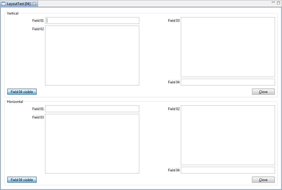

Proof of concept:
index.php/fa/17563/0/

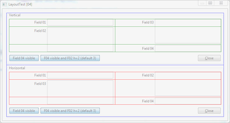

The horizontal layout will be available with 4.0.0M6.
Furthermore there is a layout debugger available to display all grid cells. Use alt-shift-f2 to get the layout displayed on any form. This feature works currently for SWT/Swing.
index.php/fa/17630/0/
For more description see Bug 428899.
- andreas
