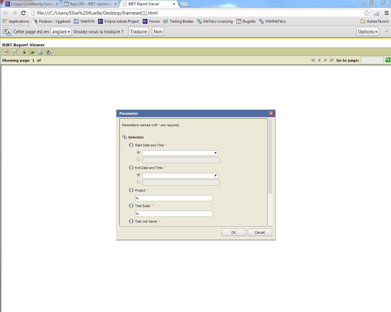

When I'm on the "Functional Test Reporting" Perspective, I select the arrow next to the 'Create ITE BIRT Report'. I select the type of report and a window is created (BIRT Report Viewer). But in this window, I have nothing as is shown by the attachment.

I don't use any browser because I use this feature from Jubula. Jubula opens a window (for me it's empty like the screenshot from my first post) and it supposed to allow me to select my preferences for the generation of a report. But if I try to save the source code of this window and execute it on chrome I can see the window to select the properties for the generation of the report as you can see in the screenshot of my browser but I can't do anything from this.

Thanks for your reply! I understand what mean Ajantha in his response. I've downgraded the version of my Internet Explorer to the version 10 and I can see the parameter window and try to generate a report.

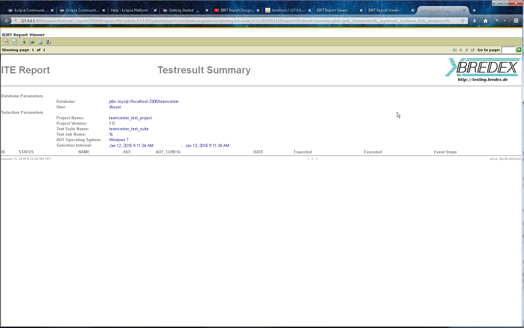

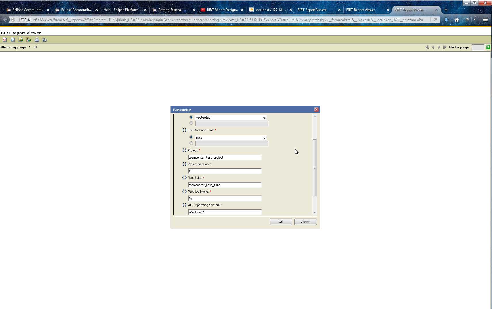

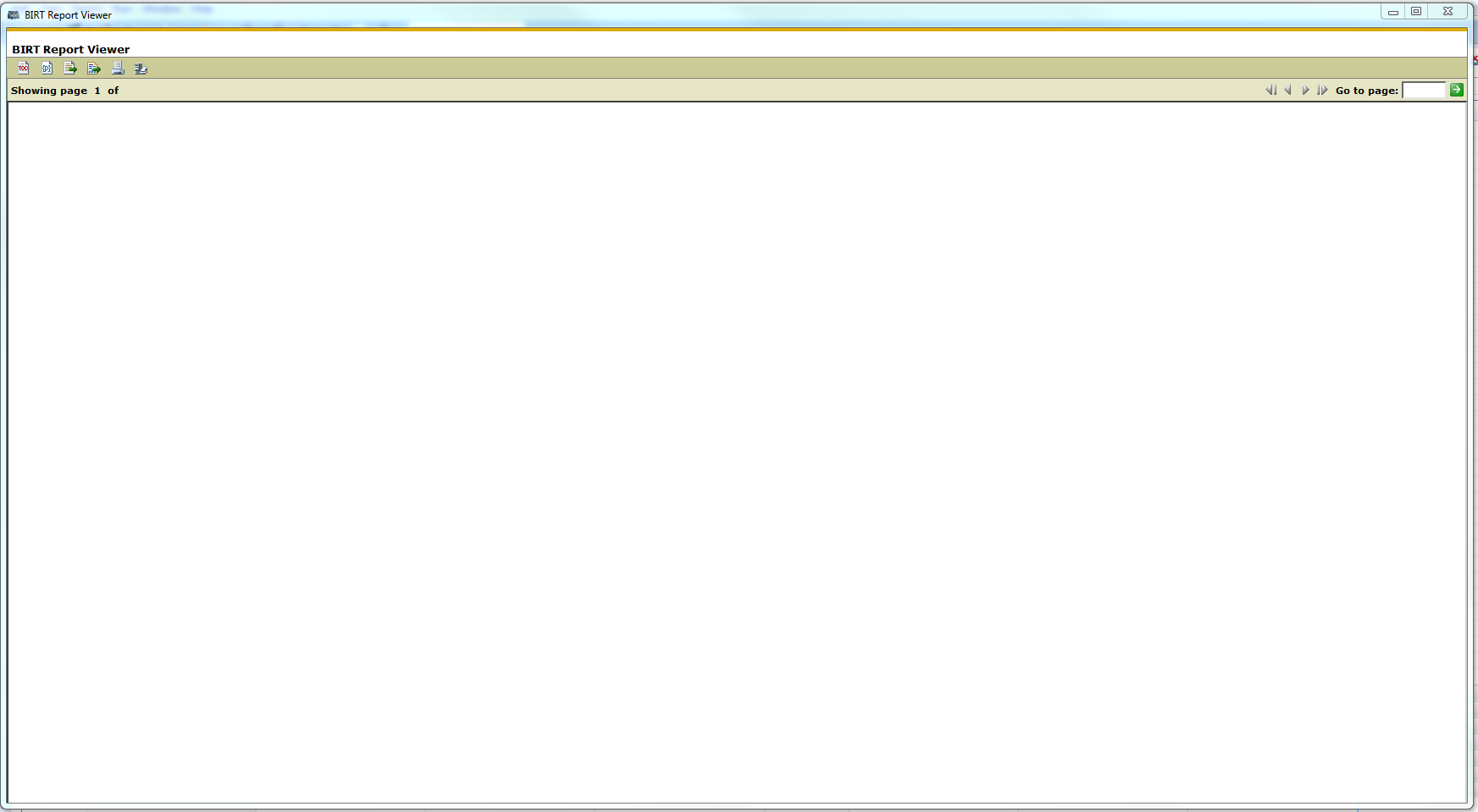

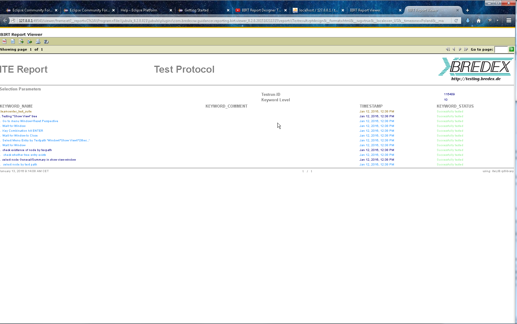

I have a problem generating BIRT report for all Reports except Test Result
[please see attachements]
I am using Jubula 8.2, Firefox 43.0.3, IE 11 (i did not work there as well) on a Win 7 machine
