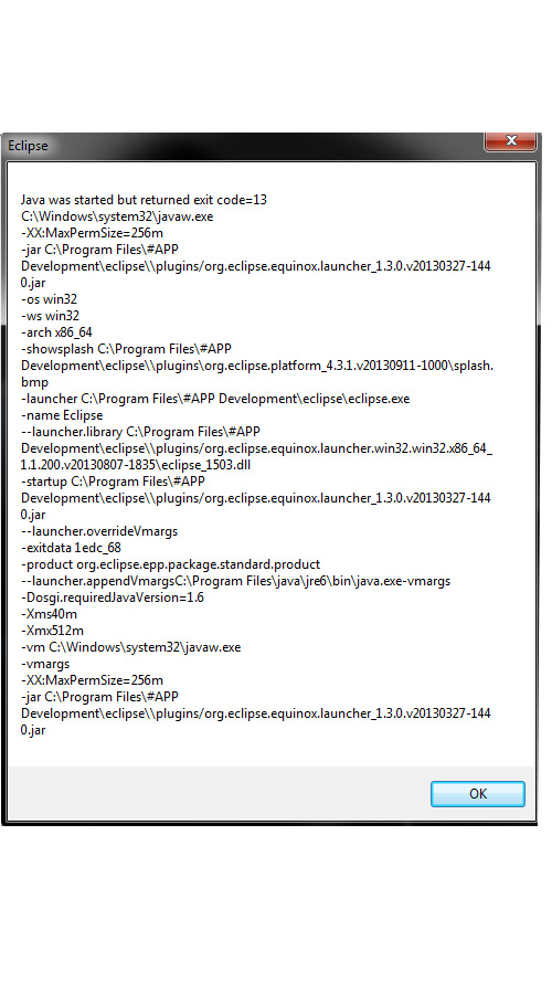

index.php/fa/17498/0/When I try to open Eclipse it shows these long lines of code for an Exit Code = 13
I have the Java JDK 7 and 6 installed 64bit and Eclipse 64 bit installed
I cannot figure out what to do?

It would seem that c:Windows\system32\javaw.exe is froma 32-bit Java, and not a 64-bit install as you expect. From a Command Prompt window, try running eclipse.exe with the -vm switch pointing to the correct javaw.exe, e.g. eclipse.exe -vm "c:\Program Files\Java\version\bin\javaw.exe"
Re: Eclipse Exit Code 13 [message #1250073 is a reply to message #1250009] Tue, 18 February 2014 18:07 Go to previous message
=> C:\Program Files\#APP Development\eclipse
'#' must not be used in the path.
