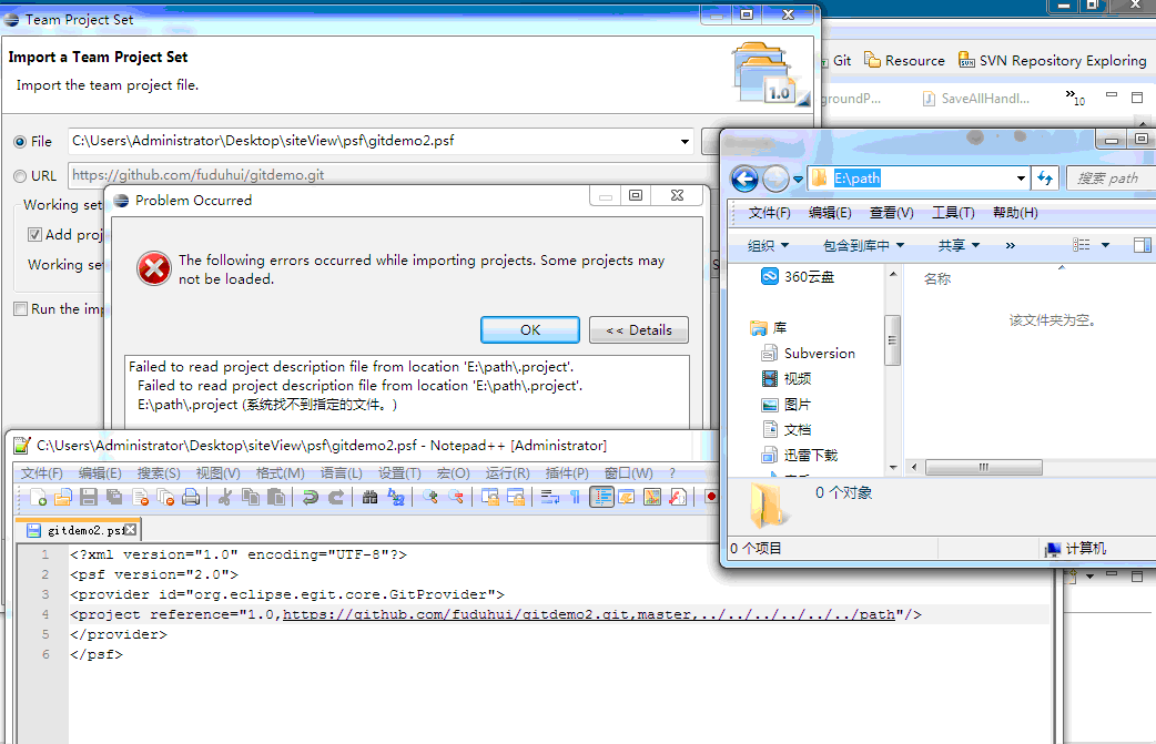

Re: eclipse team project set with egit [message #1249494 is a reply to message #1249450] Tue, 18 February 2014 04:58 Go to previous messageGo to next message
i do as you said,replace "." with a path (i call it "path A"),but a new error appears "failed to read project description".i think "path A" can be any path which exists in the system.the attachment shows the detail errores

Re: eclipse team project set with egit [message #1259904 is a reply to message #1249494] Fri, 28 February 2014 18:01 Go to previous message
the specified path should be relative to the root of the repository's working tree (don't use /..)
