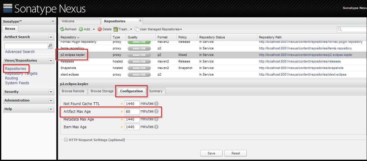

Re: Problem with automatic update of a P2 repository [message #1265838 is a reply to message #1249804] Thu, 06 March 2014 11:20 Go to previous message
An addition/remark:
I get a further problem because of an update of the Eclipse Kepler P2 libraries.
I found out that the nexus sets a standard parameter (Artifact Max Age = -1) which prevents the update of the downloaded jars.
Setting the "Artifact Max Age" to an positive value leads to the necessary update!
Nexus configuration:
index.php/fa/17660/0/
