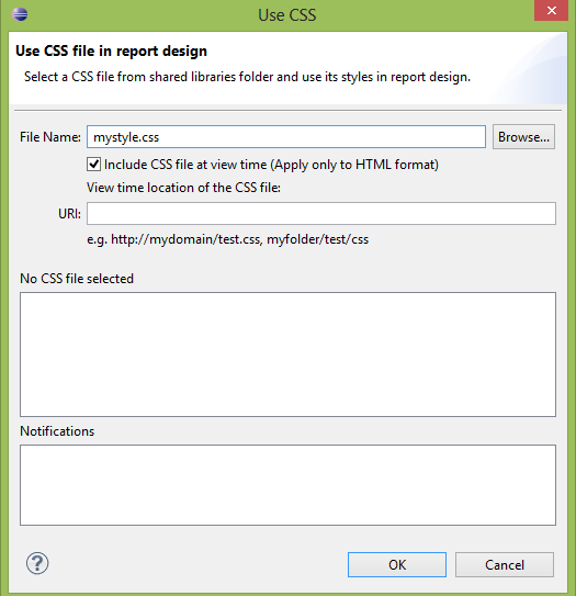

Re: How to use STYLE in HTML element? It not work [message #1245346 is a reply to message #1245274] Thu, 13 February 2014 12:22 Go to previous messageGo to next message
Actually i was thinking to something more native: in the outline view of the designer, if we right-click on the element Styles -> Use css file
We can include a css file from an absolute URI or from the resource path of BIRT. In your case, you need to check the option "Include CSS at view time"
index.php/fa/17468/0/
I hope this helps

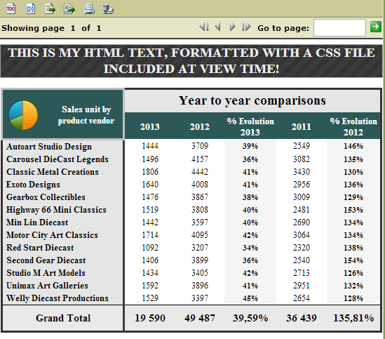

Re: How to use STYLE in HTML element? It not work [message #1245791 is a reply to message #1245543] Fri, 14 February 2014 04:16 Go to previous messageGo to next message
It works for me Martin,
There is probably an issue with the path of the css file, you should check in the development console of Chrome (or whatever browser you like Smile) if a valid css link is inserted.
I joined a sample (4.3.1) where the title is an HTML text making use of a css class "ui-widget-header". This class is defined in this external css file, hosted on Google CDN. Here is what we see in HTML format:
index.php/fa/17474/0/
I hope this helps
