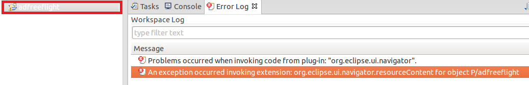

The source code compiles into binaries outside eclipse without any problem. However, when I import the source code into Eclipse as an Android application, the project folder behaves weirdly. It does not even open. Nomatter what i do with the folder (select, right click, etc), the exception appears in the error log (see below, also see screenshot in attachements).
When I import the project for the first time, I get an error message: serializing CDT project settings >>> nullpointer exception. Also C/C++ indexing fails with NPE exception.

[SOLUTION]
I have resolved the issue by manually replacing CDT plugin with the v8.1.0 version. The project now opens fine.
This obviously means that there are incompatibilities between v8.1.0 and 8.1.2 versions.
