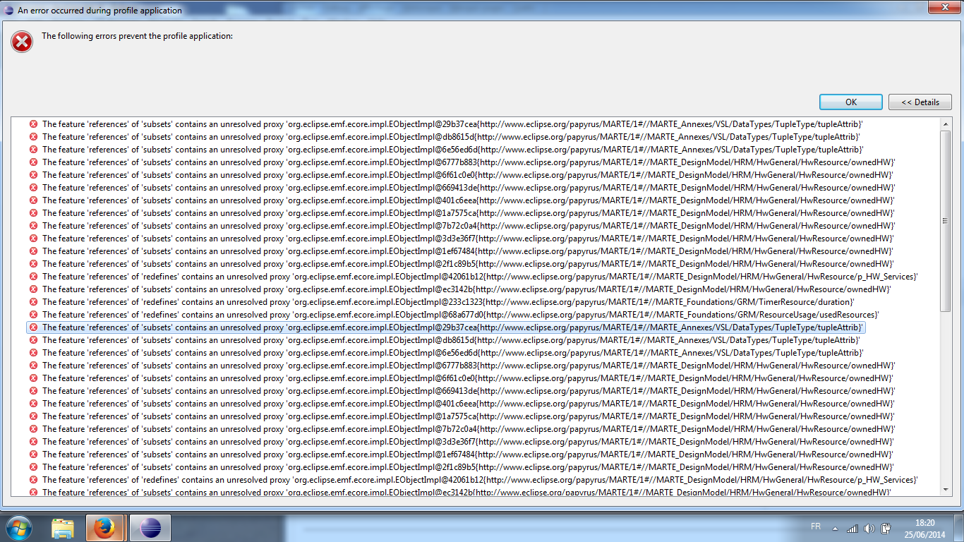

I tried to create a UML/MARTE profile using the source code of MARTE.
The profile is created and defined successfully, but i can not apply it on a model.
When trying to apply the created profile on a papyrus model, i get this error
the feature 'references' of 'subsets' contains an unresolved proxy 'org.eclipse.emf.ecore.impl.EObjectImpl@29b37cea{http://www.eclipse.org/papyrus/MARTE/1#//MARTE_Annexes/VSL/DataTypes/TupleType/tupleAttrib}'
(please see attached)
I am using Eclipse Kepler S2
Any help please ?
Thank you,
Best regards
