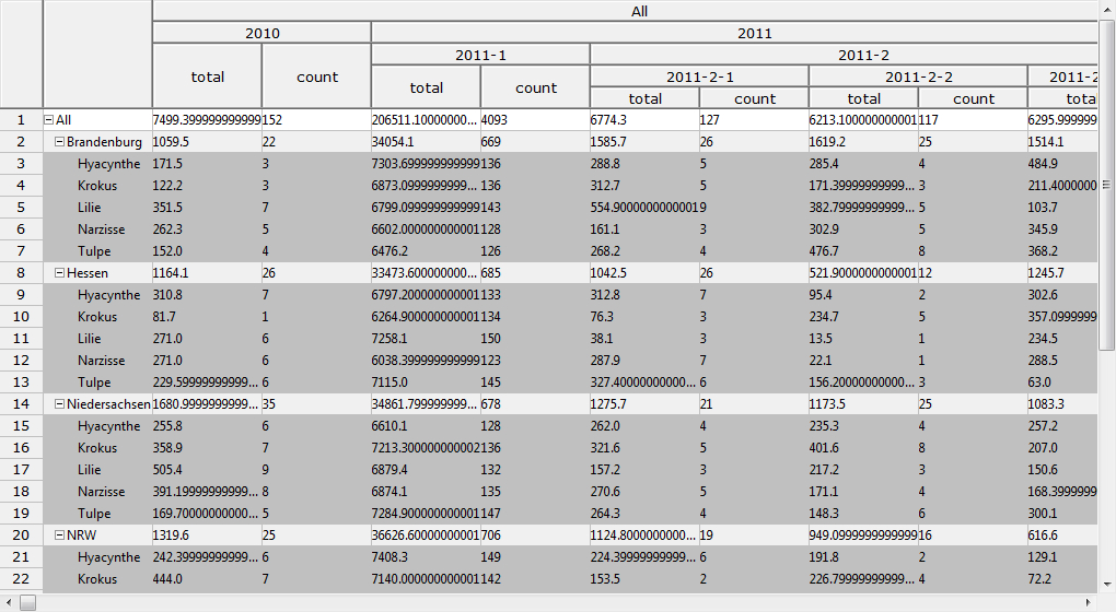

I need to create a somewhat complex configuration with NatTable. The aim is to achieve an excel-like behavior and look. Tree structure and multiple levels of column groups are also involved.
I have a problem with the multi-level column grouping. I followed the _001_Two_level_column_groups example to implement it, but this example also has the problem i encountered.
Here is a picture of how my NatTable currently looks like:
http://s30.postimg.org/84nginjpt/natttable.png
The topmost row with the colored groups is achieved with a ColumnGroupGroupHeaderLayer.
The "CAPEX FC *" groups are currently collapsed with the static "Total" column visible, achieved with ColumnGroupHeaderLayer.
The rest of the columns are grouped directly under the ColumnGroupGroupHeaderLayer.
My problem is that at the colored top-groups i'm not able to set the static columns (no method in "GroupGroup" layer), and collapsing/expanding does not work either. If i double click on a colored top group, it throws an exception like:
	at org.eclipse.nebula.widgets.nattable.group.command.ColumnGroupExpandCollapseCommandHandler.doCommand(ColumnGroupExpandCollapseCommandHandler.java:47)
	at org.eclipse.nebula.widgets.nattable.group.command.ColumnGroupExpandCollapseCommandHandler.doCommand(ColumnGroupExpandCollapseCommandHandler.java:1)
and instead of collapsing/expanding the group, it triggers a sorting command on the column "below" the event location.
I can only expand/collapse the sub-groups defined in the ColumnGroupHeaderLayer.
Is this the expected behavior?
I found a related bug: https://bugs.eclipse.org/bugs/show_bug.cgi?id=379940
Does this mean that multiple level column grouping is not fully supported? After digging into the sources and examining the exception above, to me it looks like it's not. If it is however, what am i doing wring?
I would post my code but i'm using a custom way to initialize the column groups from a hierarchical model, but in theory it works exactly like the _001_Two_level_column_groups example.

first of all, thanks for your quick reply. The issues i'm having with _001_Two_level_column_groups:
1.) if you place the mouse pointer on "GroupGroup 1" but horizontally above the "rating" column and double click, "Group 1" gets closed instead of "GroupGroup 1"
2.) if you then double click again on the exact same location, an exception is thrown and the example freezes completely
3.) if you double click on "GroupGroup 1" having the mouse pointer above "UnBreakable group 2", it closes that group again instead of "GroupGroup 1"
4.) if you double click on "GroupGroup 1" having the mouse pointer above "Issue Date", an exception is thrown and the example freezes completely
My need is to be able to configure the "GroupGroup" layer in such a way that if one double clicks on "GroupGroup 1" only the "Issue Date" column (or only group 1, 2, etc...) remains visible, like it is possible with ColumnGroupHeaderLayer.
About this: "The rest of the columns are grouped directly under the ColumnGroupGroupHeaderLayer."
If you look at "UnBreakable group 3" in the example, it's columns are added to the ColumnGroupHeaderLayer. This way the group header takes place in the upper two rows in a merged cell, and expanding/collapsing the group works properly. Unfortunately i need a different visual outcome, having the group header only taking the uppermost row and the column headers spanning vertically two rows. While i could achieve this by adding the column indices to the ColumnGroupGroupHeaderLayer instead of the ColumnGroupHeaderLayer, collapsing/expanding no longer works, if i double click on the group header, an exception is thrown and sorting happens on the column below the event's location.

I am trying to build a ColumngroupHeader with Tree. Need ideas as i see a image from you.
Till now:
I was able to display Columgroup header and created dynamic data but to display this based on tree i am struggling. need inputs here
Want to check if there are any samples and any other suggestions that would be great.

Thanks for quick reply....I had gone through those but I want the one with tree based column group header.
Some thing like attached.
Re: Misbehaving two-level column groups [message #1814995 is a reply to message #1814992] Mon, 23 September 2019 16:12 Go to previous message
That's not a tree. It is a multi level column header and can be achieved with the performance column grouping introduced with 1.6. Have a look at the N&N and the referenced two level grouping example.
