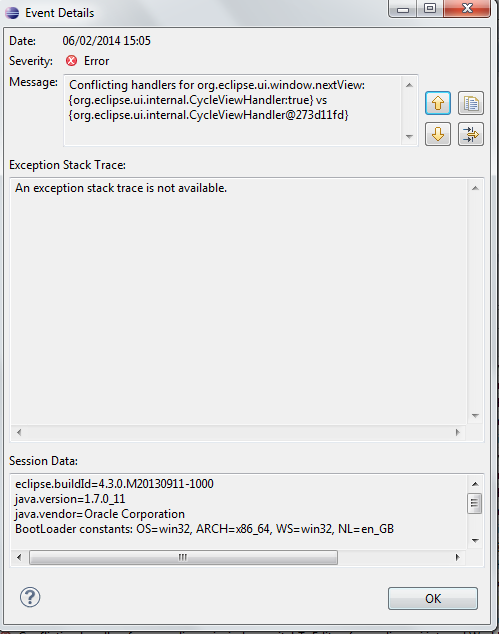

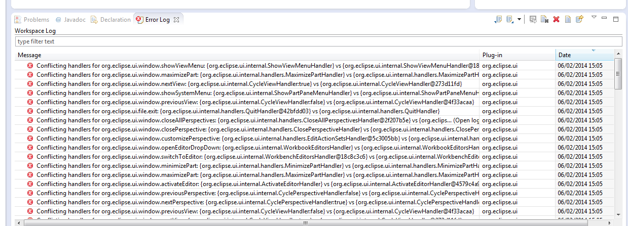

Regarding the conflicting handlers, here is how I produced the error, plus I have attached the workspace error log, and some screenshots of the errors.
THE PROBLEM:
getting multiple confilicting handler errors in error log tab such as @Conflicting handlers for org.eclipse.ui.file.closeAll: {org.eclipse.ui.internal.CloseAllHandler} vs {org.eclipse.ui.internal.CloseAllHandler@33b06b78}@
AND
previously this seemed to be causing problems in the IDE such as "Windows->OpenPerspective->Other" not showing a popup window, or file exit not closing down eclipse however I could not reproduce this.
HOW I REPRODUCED THE PROBLEM:
I downloaded eclipse from eclipse the latest modelling edition for windows 7 64 bit(eclipse-modeling-kepler-SR1-win32-x86_64),unzipped it, change the eclipse.ini to use my java 7 (added -vm C:/Java/jdk1.7.0_11/bin/javaw.exe ), started eclipse, opened the error log (windows-> show view-> error log) as it might be difficult to open later. then followed the instructions of the ecp website as folows:
Please copy this URL:
http://download.eclipse.org/ecp/releases/releases_12
Navigate to Help → Install New Software
Paste the copied URL into the text field label with "Work with" and press enter
Select all features and press next
Accept the license agreement and finish the installation
The install works ok.
Then I restarted eclipse, and I see a lot of errors in the errror log window.
I have attached the log file where they are stored , and a screenshot of the error log tab, and the result of double clicking on one error.

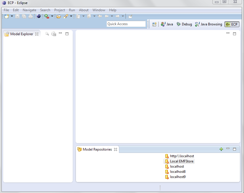

I notice that I can actually choose windows->openperspective-> other, and choose ECP.
However I still seem to get No response from clicking or right clicking on the localEMFStore icon (I have attached a screenshot). I am pretty sure I have emfstore running (I have run it org.eclipse.emf.emfstore.server.application from the run configurations). I have tried adding new links to an emfstore by clicking the green plus icon and setting these to point to localhost and port 8080, but i still have no response from right clicking on these icons.
I have tried running org.eclipse.emf.ecp.application.e3.application, org.eclipse.emf.ecp.application.e3.product, org.eclipse.emf.ecp.application.e4.product from the run configurations tab, but these never start up succefully for me.
Is there any common reason why right clicking on localemfstore would give no response? Does this suggest it cannot talk to my emfstore server?

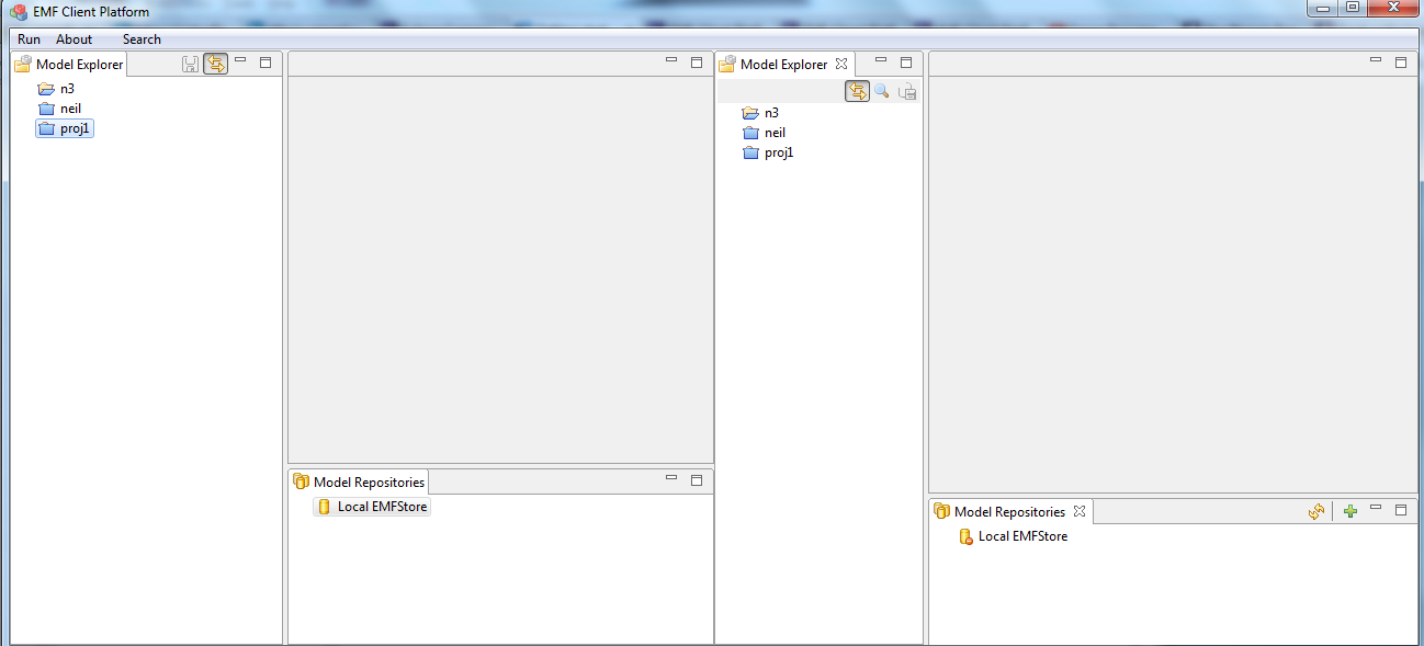

I dont really need it to run from the IDE. My final goal is to run the demo client including EMFStore from RAP. I am developing a solution using the RCP version of ECP demo client for now until I can use the demo client in RAP. I am an experienced java developer but new to RCP/RAP developement. I would be happy to help in getting RAP working fully with EMFStore, even if I can only help with testing as I learn RAP/RCP programming model.
I have the org.eclipse.emf.ecp.application.e3.application working now. previously I installed all all the components from http://download.eclipse.org/ecp/releases/releases_12 int the IDE as suggested in http://eclipse.org/ecp/download.html where it says "select all features" (I previously chose "select all" when provided with a list of components under http://download.eclipse.org/ecp/releases/releases_12) . This time I only installed the SDK as suggested in http://eclipsesource.com/blogs/tutorials/getting-started-with-the-emf-client-platform/ and now things work fine in the eclipse IDE perspective (and I no longer get the conflicting handlers message). I do see a strange thing when I start org.eclipse.emf.ecp.application.e3.application, things work fine but I see 2 model explorers and 2 repository explorerers (I have attached a screenshot) I will check myself if this is only from my environement, I dont know if its a bug yet.
