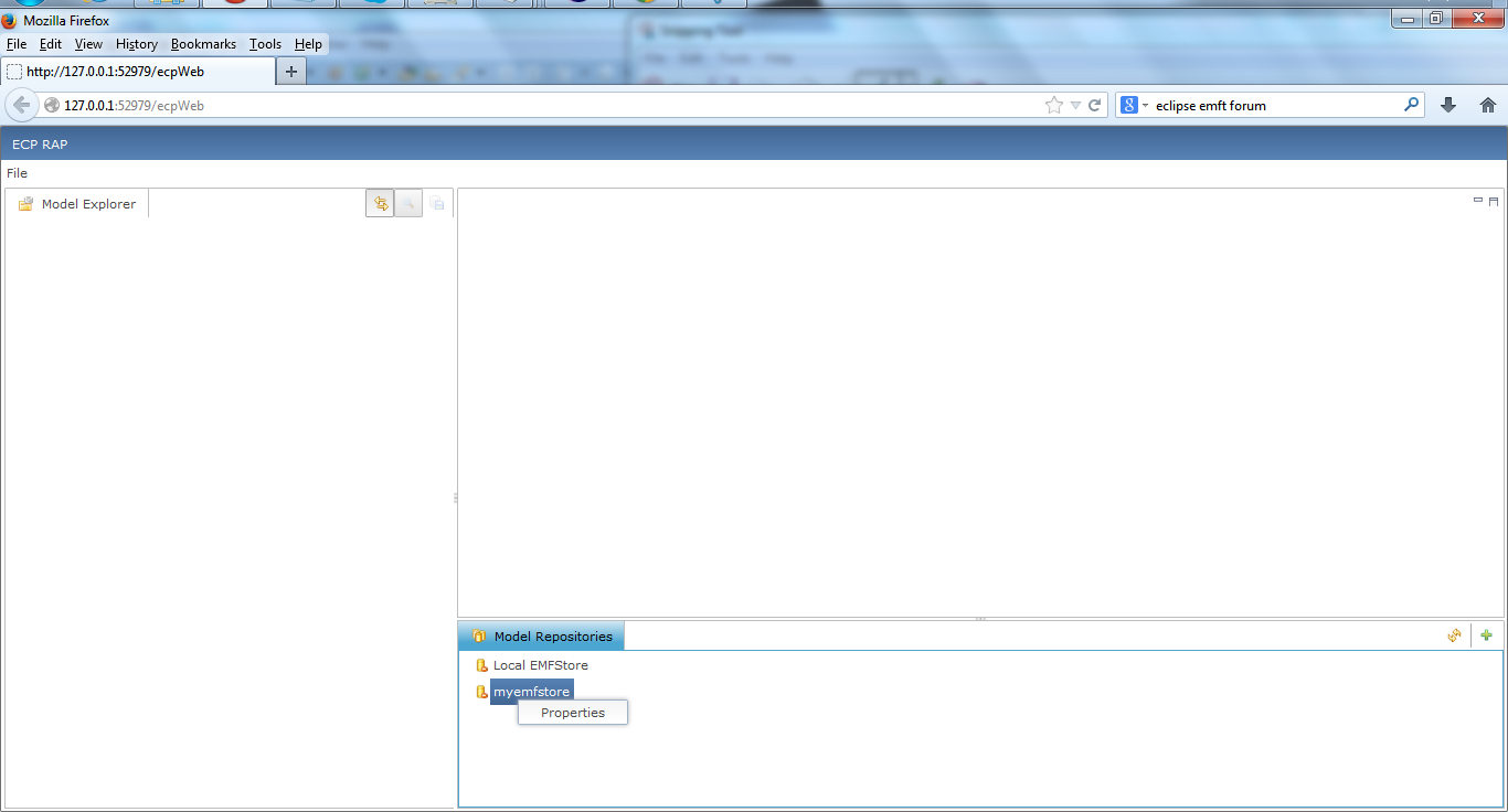

I can start up a web based RAP app, or a RCP client using the supplied launch configutrations, alhough I do need to change the selected bundles to use the org.eclipse.jface 3.9.0,instead of 3.9.1 to get the RCP client working)
However in the web and RCP front ends when I dont seem to have any option to login to emfstore. I see "Local EMFStore" and it appears from the eclipse console that EMFStore server has started up ok, but clicking or right clicking on LocalEMFStore doesnt let me login. On the web client right clicking lets me see its properties and nothing more.
Am i missing something?
Thanks for any help.

currently right clicking on Local EMFStore in RAP will only allow me to see the properties, and does not give me an option to login.
I will try running 1.2 RC1 in my target instead of running from source, and also setting up a remote EMFStore server to see if that helps.
Neil

I have been trying to get somewhere with EMFStore and RAP, but I still cannot get any basic interaction with EMFStore.
I am using ECP 1.2 RC2 RAP components in my target platform along with an RAP target.
things start up ok (with one exception reported), and I can add an EMFStore repository, but right clicking will only ever show me the properties menu item (so no option to login, screenshot attached). Because I cannot login it is hard to test EMFStore/RAP further. Can any of the developers login to EMFStore on RAP?
I am new to osgi/RAP/eclipse developement so I am still trying to understand the code a little better to figure out what i going wrong. I think the main cause might be from the single exception that is displayed when the app is started up (I have put it at the bottom of this email). It appears that the bundle org.eclipse.emf.ecp.ui.e3 gets resolved, but does not enter an active state until the first http request is made when I refresh the browser. Maybe the bundle org.eclipse.emf.ecp.emfstore.ui needs that bundle to be active earlier in order to add emfstore menu items?
The output recieved on the console when I start up is:

Re: EMFClient 1.2 [message #1248577 is a reply to message #1245814] Mon, 17 February 2014 07:17 Go to previous message
the problem is actually related to our new e4 support, but i affects 3.x
and therefore RAP compatibility.
We created:
https://bugs.eclipse.org/bugs/show_bug.cgi?id=428345
and try to fix this asap...
Best regards
Jonas
