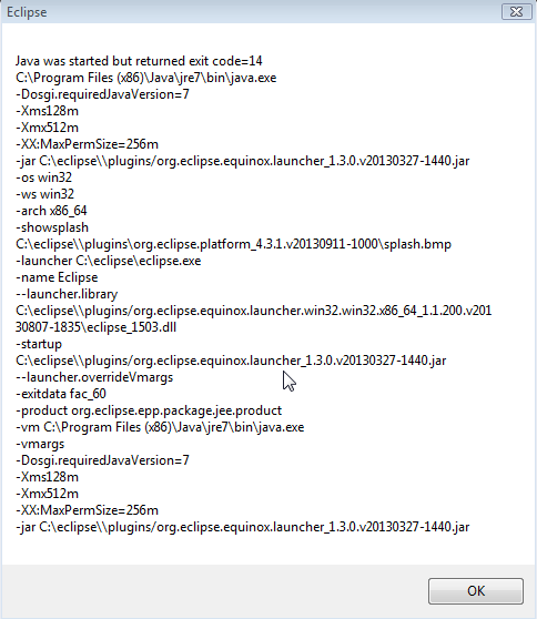

I have the folowing error.
index.php/fa/17392/0/
I am running windows vista
java_ee_sdk-7-jdk7-windows-x64-ml
eclipse-standard-kepler-SR1-win32-x86_64
at first i had error 13, but by entering -vm (path), that was solved

You're attempting to run 64-bit Eclipse on a 32-bit JVM. Change your -vm
option to point at the 64-bit JDK/JRE you say you have installed.
