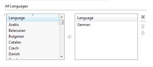

@Service(impl = LanguagePossibleValueService.class, context = Service.Context.INSTANCE)
index.php/fa/17388/0/

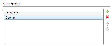

@Service(impl = LanguagePossibleValueService.class, context = Service.Context.METAMODEL)
index.php/fa/17389/0/
Is there any hint available to enforce METAMODEL rendering? Or another way to use this rendering mode.

When rendering the left side of the slush bucket, only the list property instance is available. So it must be able to access the PossibleValueService from either the list property's instance context or from the entry value property's metamodel context. In contrast, the standard table presentation has the list entry instance when you activate the cell editor and click on the browse button, so it is able to work in the case where PossibleValueService is attached at entry value property's instance level.
Typically, in cases like this, the PossibleValueService implementation needs to access the broader model, not the list entry instance, so moving @Service declaration from the entry value property to the list property would be fine for the implementation and allow you to benefit from slush bucket and checkbox list presentations.
Hope this made sense... Don't hesitate to ask for clarification.
