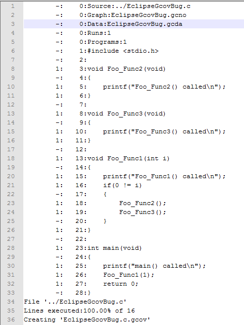

gcov command line text output file shows (correctly):
        -:  122:void
       41:  123:process( void )
        -:  124:{
       41:  125:    if ( state_updated == true )
        -:  126:    {
        -:  127:        uint8_t step;
        -:  128:
        4:  130:        step = data_shadow[STEP];
        -:  132:
        4:  133:        state_updated = false;
        -:  135:    }
       41:  136:}

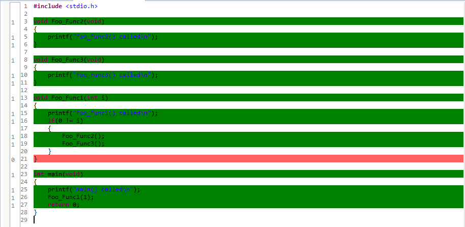

eclipse gcov plugin shows (wrong):
            122:void
       41   123:process( void )
            124:{
       41   125:    if ( state_updated == true )
            126:    {
            127:        uint8_t step;
            128:
        4   130:        step = data_shadow[STEP];
            132:
        4   133:        state_updated = false;
            135:    }
        0   136:}
The last line of the eclipse gcov plugin output shows a coverage of '0' (red) instead of '41'. This effect is only visible on some functions. Always on the last line of this functions.

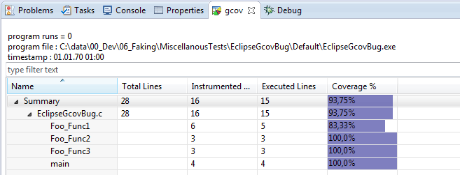

I experience the same problem. I believe this is a bug in the gcov plugin and should be reported.
In addition, sometimes lines are red that can't possibly be red, such as
if (...) [RED]
     [green]
I'm using Eclipse Kepler SR1 CDT and GCov Plugin 1.1.0.201402102340 (Cygwin with gcc 4.8.2 on a windows 7 host).

Gcov Plugin:
index.php/fa/20782/0/
index.php/fa/20784/0/
Gcov:
index.php/fa/20783/0/
