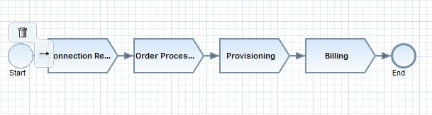

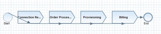

We have been facing this issue with Layouting of diagram. We are trying to format diagram using 3rd party libraries, and after the formatting, some of the connections start & end points are not at the adequate points.
I initially thought its an issue with formatting of the diagram, however after some investigation we believe its a problem with Graphiti itself. Also, when we re-open the editor the layouting happens as expected.
I am attaching two images for reference. Imgage_1 is right after the formatting and shows connections are not proper, and Imgage_2 is when we re-open the editor.
did someone face this issue already ?
Is there a workaround for this issue ?
Thanks & Regards
Hitesh

Hitesh,
have you checked if an additional refresh is needed after layout? In some
cases Graphiti cannot determine automatically what needs to be refreshed
(e.g. depending on the existing links...)
Michael
