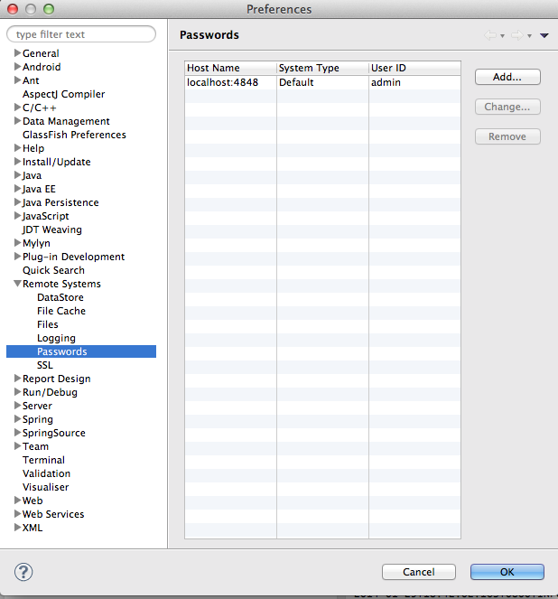

To the menu line, click "Eclipse"-->"Preferences"
index.php/fa/17355/0/
Choose "Remote System"-->"Passwords"
index.php/fa/17356/0/

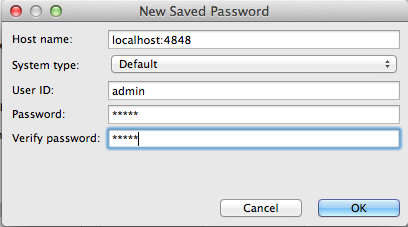

When you see the windows of "Passwords", click "Add".
index.php/fa/17357/0/
Input relative info as upper picture and click "OK" and quit the "Preferences"
Until now, try it again, I assume the trouble has been removed.
