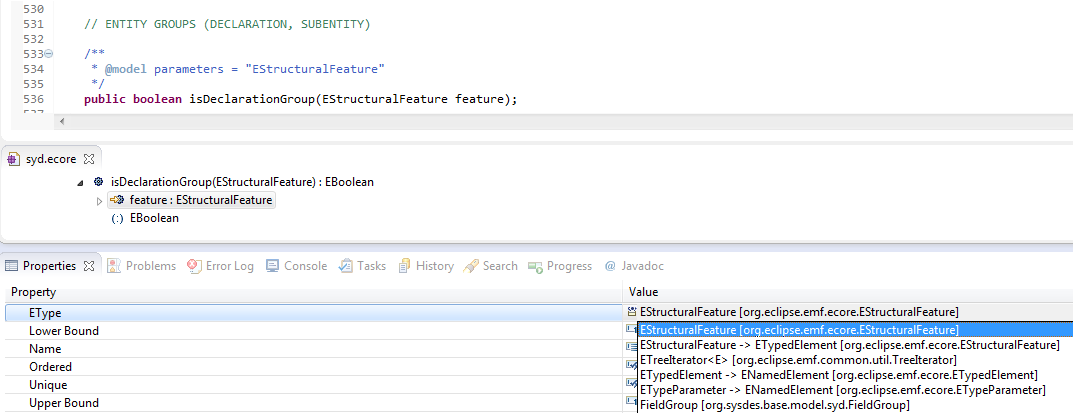

after switching to EMF 2.9 I cannot correctly generate the Ecore/Genmodel anymore. The produced ecore contains EStructuralFeatures, EReferences and EAttribures as model items instead of referencing the EMF's ecore types.
To generate my model, I use the 'Annotated Java' model import option from the IDE.
The following method:

Opening the ecore and looking at the properties of the method there are two options for the EStructuralFeature: the first as 'EStructuralFeature [org.eclipse.emf.ecore.EStructuralFeature]' while the second one is also marked as ETypedElement (see image below).
index.php/fa/17332/0/
As far as I understood, for some reasons on EMF 2.9 the model importer fails to reference the correct classes from Ecore.ecore model and hence adds them to my model stuff.

Re: Annotated Java import issues with EMF 2.9 [message #1240943 is a reply to message #1236459] Fri, 07 February 2014 03:53 Go to previous messageGo to next message
Diego,
I'm not aware of any changes in 2.9 that would break this. Please open
a bugzilla with a reproducible test case and I'll investigate.
Unfortunately the 2.9 maintenance stream is final now so any fixes might
need to be done for 2.10 instead...

Re: Annotated Java import issues with EMF 2.9 [message #1240994 is a reply to message #1240943] Fri, 07 February 2014 05:10 Go to previous message
Hi Ed,
after a few more tries I managed to get it back working by applying the following changes to the annotation:
1. Always fully qualifing the referenced ecore Objects when used as method parameters. So the following occurences
@model parameters = "EStructuralFeature"
@model parameters = "EReference"
@model parameters = "EAttribute"
have been replaced by
@model parameters = "org.eclipse.emf.ecore.EStructuralFeature"
@model parameters = "org.eclipse.emf.ecore.EReference"
@model parameters = "org.eclipse.emf.ecore.EAttribute"
2. Adding the dataType annotation when ecore model objects are used as method return type.
The following case
 * @model parameters = "String"
public EStructuralFeature getFeature(String typeLabel);
has been updated with following annotation
 * @model dataType="org.eclipse.emf.ecore.EStructuralFeature" parameters = "String"
Apparently in the previous versions EMF where able to handle the missing dataType annotation and recognized the Ecore objects even when they weren't specified by their fully qualified name.
