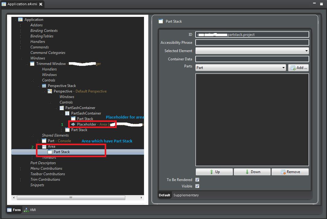

I have RCP application based on compatibility layer.
In UI I have Area(which contains Part Stack) like shown in below image.
index.php/fa/17297/0/

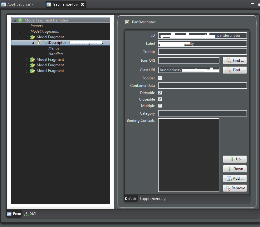

I created one Part which opens in above Area, see below.
index.php/fa/17298/0/
Now the problem is when I close my part, part is closing but i'm getting following Exception.
