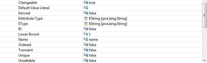

Hi Ed,
Sory for late answer.
My all attributes " ID = false " like added pic. The problem might be different. But still i can't find
  • Attachment: property.png
    (Size: 14.31KB, Downloaded 158 times)
Re: How can i save option for element as QualifiedName ? [message #1249271 is a reply to message #1248652] Mon, 17 February 2014 23:47 Go to previous message
Have a look at what's happening in
org.eclipse.emf.ecore.xmi.impl.XMLResourceImpl.attachedHelper(EObject).
That should be called for each object attached to the resource (i.e.,
for each object contained by the resource). It should assign an ID.
