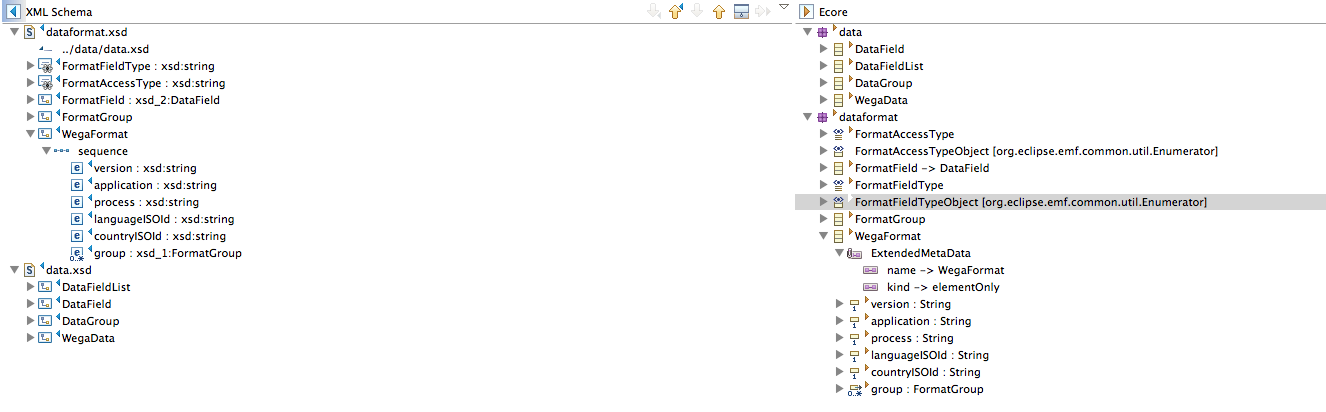

The setExtendedMetaData method is called, but the extendedMetaData object seems not to hold any data in its registry.
I will check whats going on in the org.eclipse.emf.ecore.xmi.impl.XMLHandler.handleXSINoNamespaceSchemaLocation(String) method.
Greetings,
Sascha

Re: EMF Model, Resource loading issue [message #1243217 is a reply to message #1243128] |
Mon, 10 February 2014 12:30   |
Eclipse User |
Sascha,
The generated code you indicates that you've generated this your model a
schema that has a target namespace but you've been showing me XML
instances that can only conform to a schema without a target
namespace. Something is inconsistent. Where is this schema? Where did
this XML instance come from?

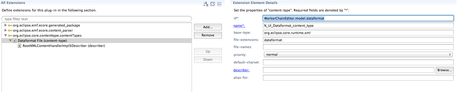

Re: EMF Model, Resource loading issue [message #1252325 is a reply to message #1251767] |
Fri, 21 February 2014 00:16   |
Eclipse User |
Sascha,
For each GenPackage, set the Content Type Identifier. Uses something
like the qualified Java package name into which you are generating that
GenPackage's interfaces. Then regenerate. You should see the
plugin.xml for the model and the editor plugin reflect the registrations
associated with that content type identifier. (In older versions of
EMF, pre-2.9, you'd need to delete the plugin.xmls to regenerate them.)
On 20/02/2014 4:22 PM, Sascha Smoo wrote:
> Hello Ed,
> I've just generated my own xsd from my xml files and now everythings
> works fine, except for one huge problem. As you said before I will get
> in trouble if I use 2 models using the same file extensions for their
> resources. You were
> talking about registering content types for every type of resource.
> Could you explain this to me or give me a hint how to do this and how
> to make my 2 editors aware of the different content types?
> Greetings,
> Sascha
Re: EMF Model, Resource loading issue [message #1252500 is a reply to message #1252325] |
Fri, 21 February 2014 04:25   |
Eclipse User |
Hello Ed,
ok, I've just tried it the way you've said, but it doesn't work for me. Everything seems to be finde, I have just set the content type identifier in both genPackages and the generated everything. Now the plugin xmls contain the newly generated content type extension point. But as you can see it says file extension "dataformat" but it needs to be xml. I've done the same to my other model and editor and there it says "workerchain" instead of xml. If I change both to xml it does not work, and If I keep the workerchain/dataformat extensions it does not work either. So what am I missing here? When I'm adding xml file extension to both content types, I run into the same old problem again... I can only open one type of editor with xml files, running both editors in my application leads to problems.
Another thing I have mentioned is that the "org.eclipse.emf.ecore.extension_parser" extension point is not generated anymore.
Greetings,
Sascha
[Updated on: Fri, 21 February 2014 05:08] by Moderator
Re: EMF Model, Resource loading issue [message #1252541 is a reply to message #1252500] |
Fri, 21 February 2014 05:20   |
Eclipse User |
Sacha,
Comments below.
On 21/02/2014 10:25 AM, Sascha Smoo wrote:
> Hello Ed,
You've set a different identifier for each one?
You've changed the File Extension property to "xml" for both of them?
> I've done the same to my other model and editor and there it says "workerchain" instead of xml. If I change both to xml it does not work, and If I keep the workerchain/dataformat extensions it does not work either. So what am I missing here? :(
What specifically doesn't work?
No, it should use the content_parser extension point for both. And
it's important you change the file extension in the generator because
you'll notice this affects the generated extensions in the plugin.xml of
the editor projects.
> Greetings,
> Sascha

Sascha,
Sorry it's taking so long to arrive at a solution. Unfortunately this
content type stuff is quite complicated. Note that your registration is
calling this constructor:
org.eclipse.emf.ecore.xmi.impl.RootXMLContentHandlerImpl.RootXMLContentHandlerImpl(Map<String,
String>)
From the Javadoc (or source code) for that, you can see all the
parameters that are accepted. It includes "elementNames" so you could
specify "process" as the value so that the content type will match only
if the root element is named "process" for workchains. For dataforms you
could list (space separated) all the allowed root element names...
It seems as if that should do the trick. In the worst case, you should
be able to implement your own subclasses to do content type recognition
in some arbitrary way not restricted to what I've already try to provide
directly in EMF...

On 24/02/2014 1:14 PM, Sascha Smoo wrote:
> Hello Ed,
> finally this did the trick for me:
> <extension point="org.eclipse.core.contenttype.contentTypes">
> <!-- @generated workerchain -->
> <content-type
> base-type="org.eclipse.core.runtime.xml"
> file-extensions="xml"
> id="WorkerChainEditor.model.workerchain"
> name="%_UI_Workerchain_content_type"
> priority="normal">
> <describer
> class="org.eclipse.emf.ecore.xmi.impl.RootXMLContentHandlerImpl$Describer">
> <parameter
> name="elementNames"
> value="process">
> </parameter>
> </describer>
> </content-type>
> </extension>
> I've just defined a "elementNames" Parameter in both of my content
> type definitions. They are automatically used to init the
> RootXMLContentHandlerImpl class. Now the content type methods work as
> intended. =)
> Thanks and greetings,
> Sascha
