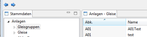

Background:
In our application do we have a setup with a clas that extends AbstractOutline. This class adds classes which extends AbstractPageWithNodes in the execCreateChildPages(Collection<IPage> pageList) method.
The classes that extends AbstractPageWithNodes adds classes that extends the class AbstractPageWithTable in the execCreateChildPages(Collection<IPage> pageList) method.
What we can see in the attached screenshot is a part of the above described construct.
Problem:
If the selection changes (with the mouse) between the nodes "Glesigruppen" and "Gleis" are to fast, (switching back and forth), then the selection in the tree structure and the displayed table is sometimes out of sync.
index.php/fa/17262/0/
Question:
Is this a known problem or something that we have done wrong in our application?

thank you very much for the question.
I just tried it with our sample application and I experience the same problem.
I opened Bug 425892 for you.
Do you have any other questions where we can help?
