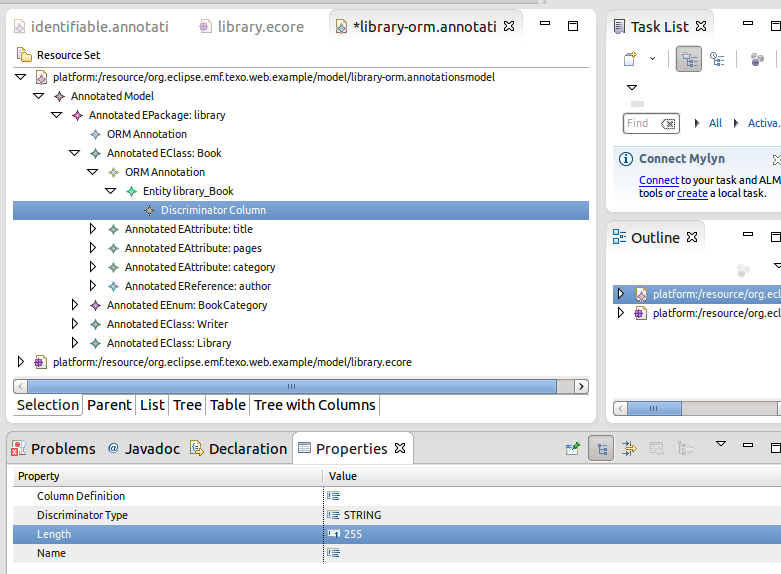

I've got some classes sharing the same parent and therefore use the same table in the database. The problem is that the DTYPE column is limited to 31 chars. Unfortunately my class names are very long. I changed the column length in the database, but I'd like to change it in the orm-annotationsmodel (or somewhere else) of Texo. Is this somehow possible?

In the annotationsmodel, see the attached screenshot for an example.

thanks Martin. Seems I missed that Smile
