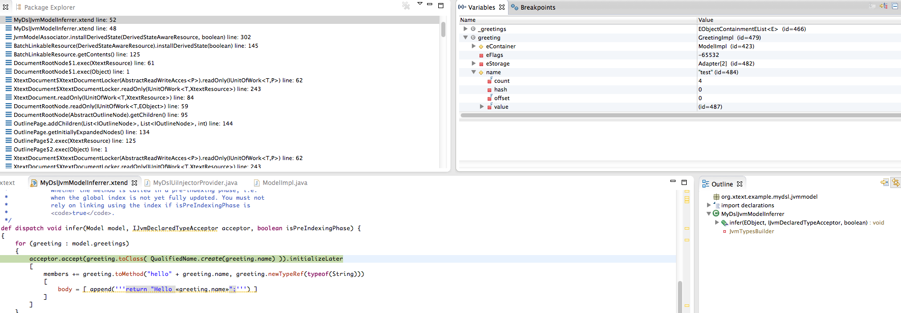

the '.' and '!' get underlined and Hello is highlighted. The outline shows two elements which is wrong and
model inferrer is called twice. First time for 'test' Qualified name and second an empty string.
index.php/fa/17219/0/
I expected that the inferrer would be called once with 'name' set to test.Hello
