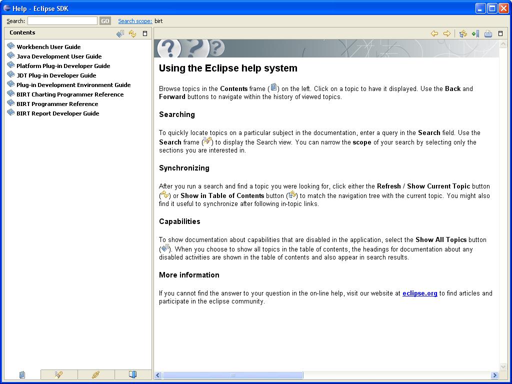

You should see three BIRT help sections as shown in the attachment.

The attachment shows what I expect to see when I look at the Eclipse
Help Contents. My problem is while I see entries for other plugins I
have no entries for BIRT.
