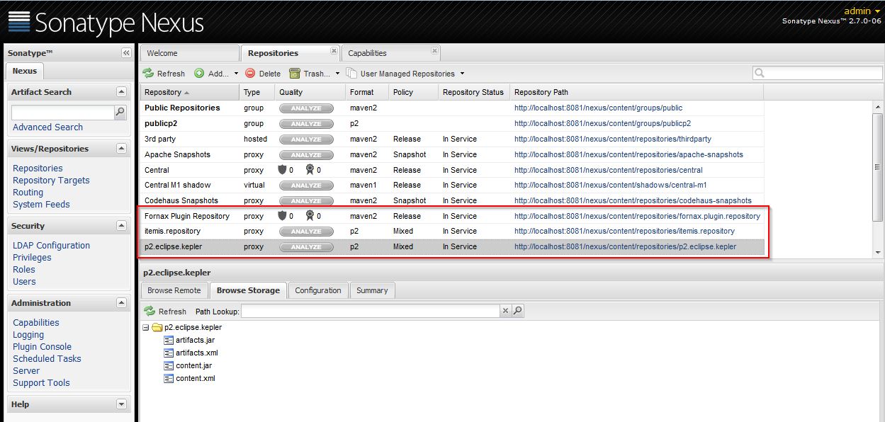

Picture Nexus:
index.php/fa/17159/0/SonatypeNexus.jpg

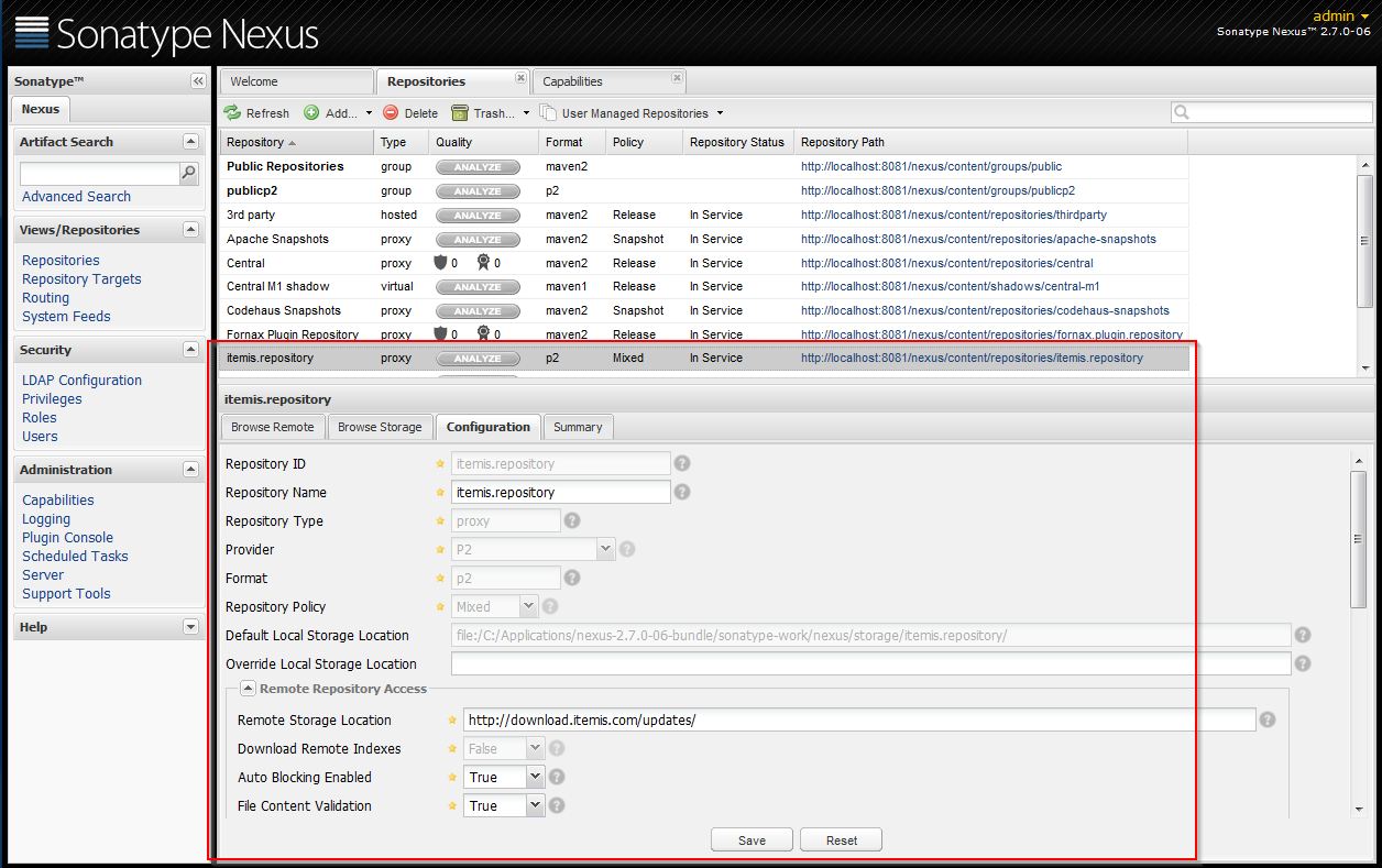

I have added the itemis repository which is necessary for the build but the first accessed P2 repository is the kepler one, so the error remains.
I added the "mvn -X install" log as file attachment.
Moreover I post the MANIFEST.MF content.
Nexus itemis repository:
index.php/fa/17161/0/

Re: Maven build using Nexus with P2 repositories [message #1228598 is a reply to message #1228538] Tue, 07 January 2014 10:31 Go to previous messageGo to next message
Yes, it works directly. In the direct way there was never a problem.
But my final infrastructure has no internet access. I can only access a nexus repository via Intranet.
Do you have experiences with Nexus (P2) and XText or even an example of use?
Thank you in advance
Adrian
Re: Maven build using Nexus with P2 repositories [message #1228606 is a reply to message #1228598] Tue, 07 January 2014 10:46 Go to previous messageGo to next message
we use this scenario in production and it more or less works fine.
but we dont use this mirror thing in settings xml for p2 stuff but for maven stuff only.
so we basically use it for *
for the p2 things we use the public urls nexus offers (think link on the right in the repo view)
Re: Maven build using Nexus with P2 repositories [message #1228612 is a reply to message #1228606] Tue, 07 January 2014 11:07 Go to previous messageGo to next message
p:S: nexus p2 repos are cached proxied and not mirrored => you have run it at least once with net available.
Re: Maven build using Nexus with P2 repositories [message #1228624 is a reply to message #1228612] Tue, 07 January 2014 11:46 Go to previous messageGo to next message
My expectation was that the Nexus has Internet access and obtains the necessary data to provide the libraries via the mirror.
I think I had a wrong view on this matter.

Re: Maven build using Nexus with P2 repositories [message #1228626 is a reply to message #1228624] Tue, 07 January 2014 11:50 Go to previous messageGo to next message
hi if the nexus has access it works fine.
if you cut the access the build has to have done all stuff at once before (though execting the build).
btw there are other ways todo real mirroring anyway.
http://wiki.eclipse.org/Equinox_p2_Repository_Mirroring
Re: Maven build using Nexus with P2 repositories [message #1228628 is a reply to message #1228626] Tue, 07 January 2014 11:52 Go to previous messageGo to next message
so did you try to fix the poms?
Re: Maven build using Nexus with P2 repositories [message #1228866 is a reply to message #1228628] Wed, 08 January 2014 03:36 Go to previous messageGo to next message
Which fix within the pom do you mean?
Re: Maven build using Nexus with P2 repositories [message #1228921 is a reply to message #1228866] Wed, 08 January 2014 05:52 Go to previous messageGo to next message
as i said
e.g. using
http://mynexus:port/nexus/content/repositories/<see nexus repo page for complete url>
instead of
http://download.itemis.com/updates/
Re: Maven build using Nexus with P2 repositories [message #1229063 is a reply to message #1228921] Wed, 08 January 2014 11:26 Go to previous message
Hello Christian,
you finally hit the mark. Smile
After referencing the nexus repositories directly and changing the mirror to "central" all necessary libraries are stored within the local repository "C:\applications\maven-repository".
At the end everything was build without an error.
As a resume there are two results I achieved within the final solution.
Both parts are done in one offline Maven build (Nexus OSS with p2 repositories required):
- Generate DSL Interpreter with Fornax plugins
- Use generated DSL Interpreter as a plugin to generate artifacts out of model files
Thank you very much for your help - once again!

</settings>
Used repositories within the releng pom:
<repositories>
  <repository>
    <id>itemis.repository</id>
    <url>http://localhost:8081/nexus/content/repositories/itemis.repository</url>
    <layout>p2</layout>
  </repository>
  <repository>
    <id>p2.eclipse.kepler</id>
    <url>http://localhost:8081/nexus/content/repositories/p2.eclipse.kepler</url>
    <layout>p2</layout>
  </repository>
</repositories>
<pluginRepositories>
  <pluginRepository>
   <id>fornax.plugin.repository</id>
    <name>Fornax Plugin Repository</name>
    <url>http://localhost:8081/nexus/content/repositories/fornax.plugin.repository</url>
  </pluginRepository>
</pluginRepositories>
