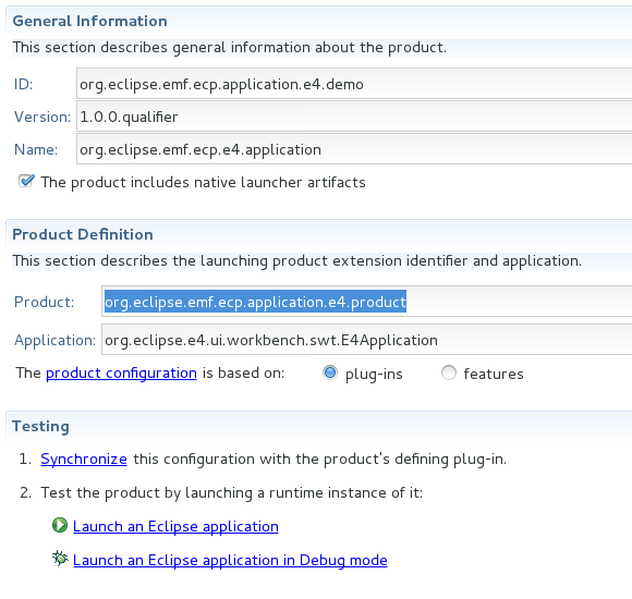

Hi Jonas,
now I have used the product configuration from here: github.com/eclipse/emf.ecp.other/blob/master/extra/org.eclipse.emf.ecp.application.e4/org.eclipse.emf.ecp.application.e4.product
If I Launch my application with the button in the testing section of the product overview I get an error message (attached test.log), which says that org.eclipse.emf.ecp.application.e4.product could not be found.
There are plug-ins missing in the dependency-tab, especially org.eclipse.emf.ecp.application.e4 and org.eclipse.emf.ecp.e4.application. The other missing ones are platform-dependant (carbon, cocoa, win32...).
Where do I get the Ressources for org.eclipse.emf.ecp.e4.application or org.eclipse.emf.ecp.application.e4?
Or do I have to change something else in my product configuration to make eclipse find my product? (see attached image for current configuration)
I hope this helps you to help me Smile
If you need any more information - let me know.
Chris

the platform specific bundles are not in the configuration. They are
added during the export. You can build this with maven tycho and you
should get products for the different platforms then.
If you want to launch it, you need to add the platform specific parts to
the run configuration (try "add required").
Jonas
