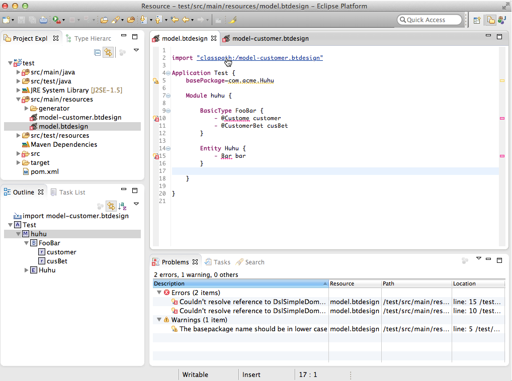

icon14.gif  Re: How to implement hyperlinking for URI of importURI grammar element? [message #1226469 is a reply to message #1226465] Wed, 01 January 2014 17:01 Go to previous messageGo to next message
Hi Christian,
thanks for the fast response. Your code snippet is perfect.
Cheers,
/Torsten
Re: How to implement hyperlinking for URI of importURI grammar element? [message #1226489 is a reply to message #1226469] Wed, 01 January 2014 18:03 Go to previous message
And it's working like a charm Smile
