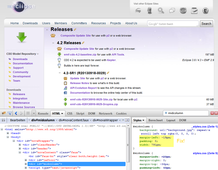

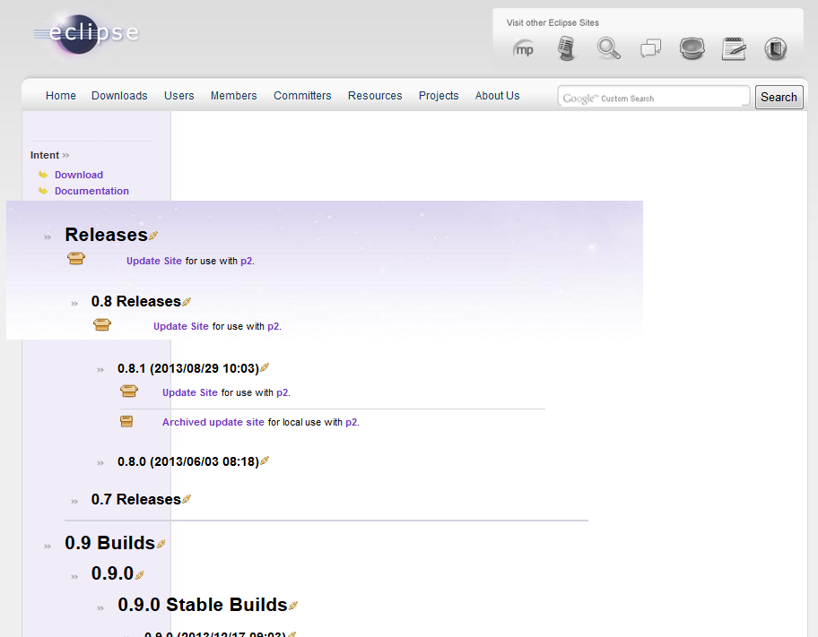

Under Firefox 25.0.1, Windows 7, the pages are not correctly displayed (see attached screenshots: intent_downloads.png, cdo_download.png).
I am not an HTML expert, but it seems to me that the <div id="midcolumn"> is floating under <div id="leftcol">.
With the help of FireBug, I found out that the problem comes from the padding elements defined in
http://www.eclipse.org/cdo/_projectCommon/styles.css
#midcolumn {
    margin-left: -20px;
    margin-right: 0;
    margin-top: -36px;
    padding-left: 40px;
    padding-right: 50px;
    padding-top: 20px;
    width: 703px;
I have tried to fix it by introducing following CSS:
#midcolumn {
    margin-left: -19px;
    padding: 0;
    width: 791px;
In the file:
http://www.eclipse.org/cdo/_projectCommon/styles.css (to instead of the currently defined values)
or in the file:
http://www.eclipse.org/cdo/downloads/_styles.css (to override what is defined in styles.css)
This brings the #midcolumn div at the correct position, but it is not perfect (the text is on the border... padding is missing). See possible_fix.png
I am not sure if this is possible, but I think it could be good to introduce a second div #midcolumn_content as child div of #midcolumn div. This way it could be possible to define the background in the #midcolumn div and to control the text position (padding) in the #midcolumn_content div.
Let me know if and how I can help here.
