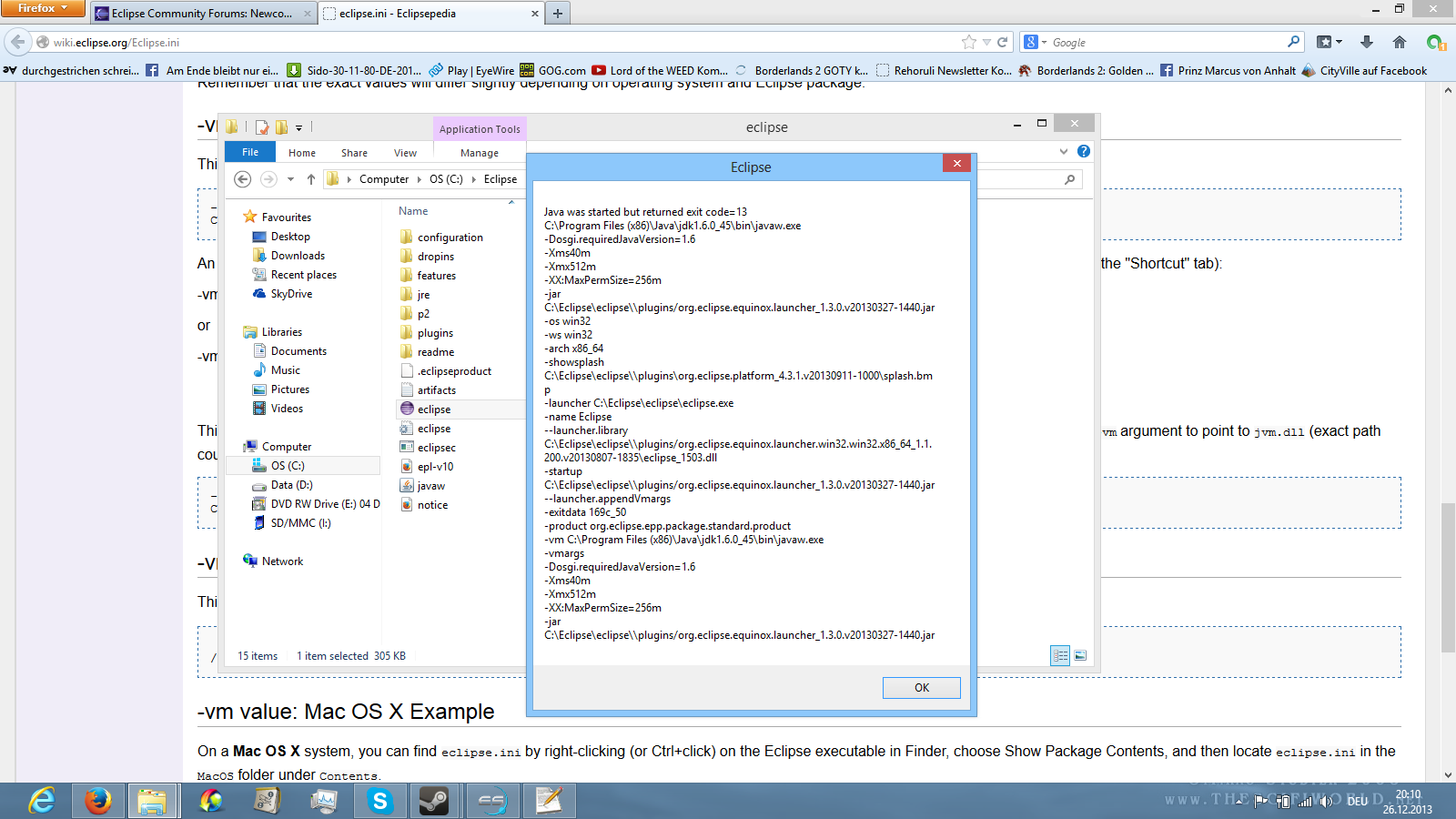

Hi. I installed Eclipse and downloaded the JDK 1.7. After i tried starting eclipse with this it gave me an error message, which pretty much said it needed 1.6. I got 1.6 but it will still not work. I did follow the sticky note and specified the javaw.exe's location in the .ini file, but it still gives me this error.

It's not saying anything about 1.6. It is showing that you're trying to run a 64-bit Eclipse with a 32-bit Java. They both have to match being 32-bit or 64-bit.
Re: Eclipse wont start [message #1224787 is a reply to message #1224761] Fri, 27 December 2013 14:46 Go to previous message
Thank you very much, I'll get myself a 64-bit asap. THANKS
