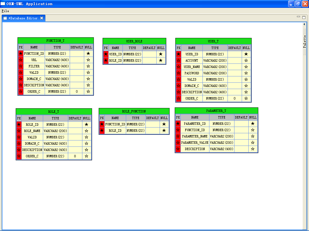

I am programing a tool for O/R mapping with GEF+RCP.
I had finished most functions.
But i get a serious problem.
How to do layout.
After i get the information of tables and views,
i show them in a viewer with GEF.
But at first,there is no location of every one.
Now i need a auto layout to arrange them in suitable position.
Because there are relations between the tables,
so i can't arrange them with grid.
Does anyone have good solutions.

I haven't used it myself, but the
org.eclipse.gef.examples.flow.parts.GraphLayoutManager in the
org.eclipse.gef.examples.flow example (available via CVS) seems to do
something like that.
