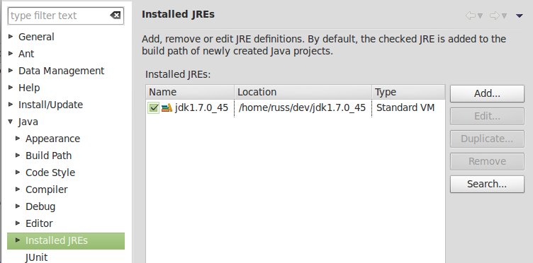

Eustace,
You're close. You should see something like this: (see attachment)

Yes, I am seeing it. What next?

The next step is to ensure that your project's class path stuff is
correct. Do the following:
1. Right-click on the project, choose Build Path -> Configure Build Path.
2. Click the Libraries tab.
3. Look for JRE System Library [jdk1.7.0_45].
You might be missing that library or you might have a different one with
a red decoration of sorts on it that means that the original JRE library
is actually missing. You need to correct this:
4. If a bad one is there, click to select and choose Remove. Then, ...
5. Click Add Library...
6. Click JRE System Library.
7. Next.
8. Either allow it to use the workstation default (which should be the
one I illustrated in a prior post) or make other arrangements (like find
another JDK you've downloaded to your host.
9. Click Finish.
That should sort things out.
