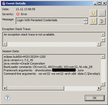

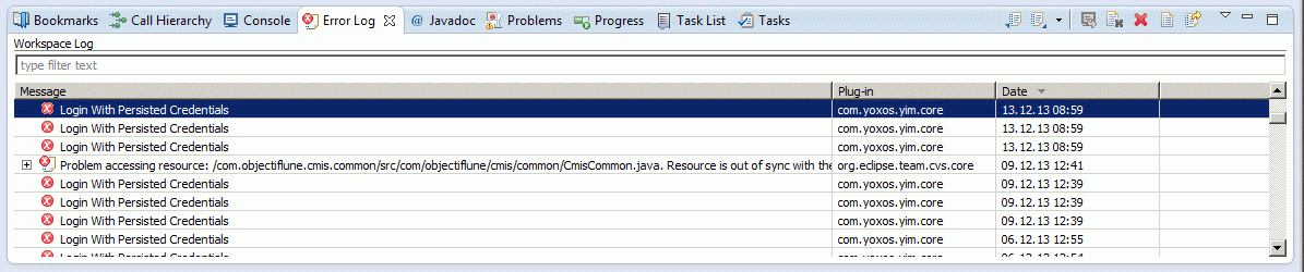

Re: Mysterious error message "Login With Persisted Credentials" [message #1220786 is a reply to message #1220739] Fri, 13 December 2013 10:23 Go to previous messageGo to next message
Now, yes, the message is marked as Error. See attached screenshots.

Yeah, your right. Here's an example from the internet:
!ENTRY com.yoxos.yim.core 4 4 2012-08-04 23:22:37.420
Notice the '4' after com.yoxos.yim.core. 4 says error.
Because the example from the net then had
!ENTRY com.yoxos.yim.core 4 4 2012-08-04 23:22:46.650
!MESSAGE Login successful.
Which is also marked as an error. I don't understand why a good login
would be an error. My guess is that yoxos was being lazy and just using
'error' severity for everything.
Rich
