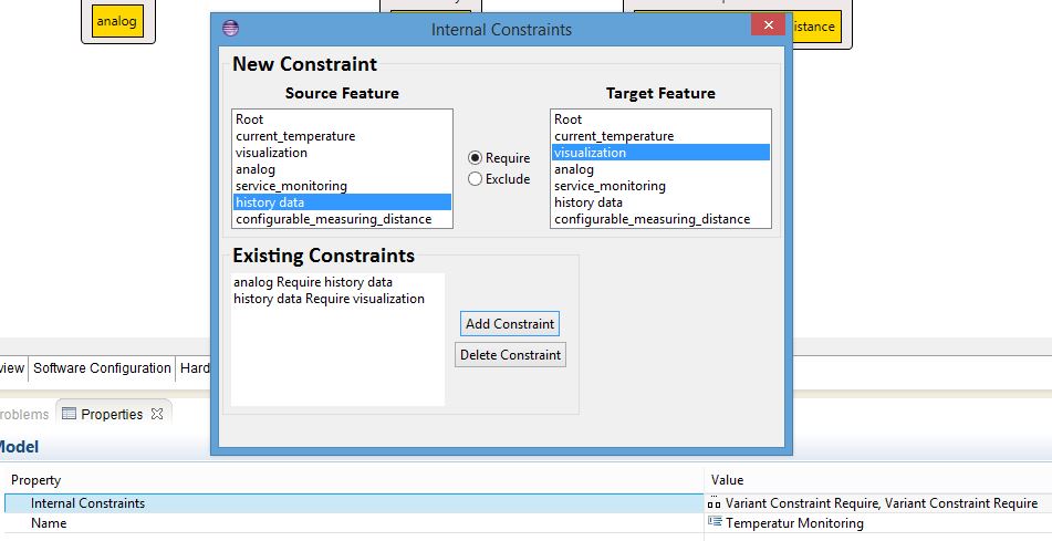

I've created a custom property dialog for one of my properties. Within this dialog, I'm able to add elements, as you can see here:
index.php/fa/16997/0/
I've realised this through an AddCommand:

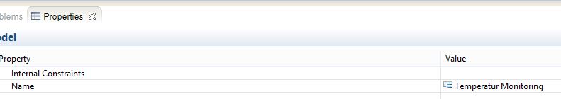

This works fine so far, but when I'm saving my file, close it and open it again, the properties are removed:
index.php/fa/16998/0/
What can be the problem?
