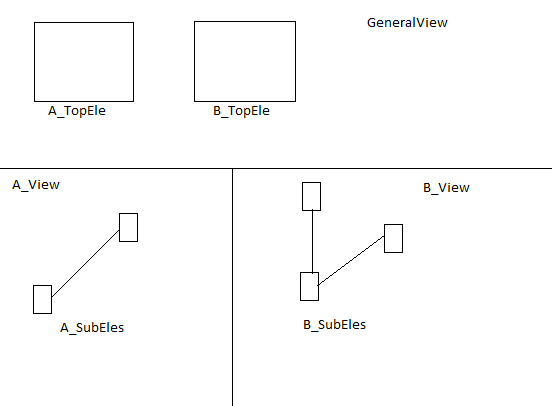

Hi Maxime,
I have tried the java service you provided above, it do works for adding a new layer to the current diagram, but I would like to remove the previous layer from the diagram, it seems not possible. I have it like this:
EList<Layer> currentLayers = diagram.getActivatedLayers();
diagram.getActivatedLayers().removeAll(currentLayers);
Is that because the DefaultLayer could not be removed or the restriction of double-click event which does not allow the element triggers the double click to be removed.
My goal is the same as described above, I need a more detailed view of one specific element after double-click while the general view should not be shown at the same time. And there needs some way to go back to the generalView in detailedView.
index.php/fa/18239/0/
As shown in attachment image, The generated view should only contain "A_TopEle" and "B_TopEle", when user click A, "A_SubEles" should be seen and if B_Top is clicked, only "B_SubEles" are shown. I have thought about using different presentations or diagrams to show, but pass the targeted element could be a problem or? Could you give me some suggestions here which would be better to handle this situation?
KR,
Winny
