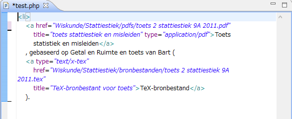

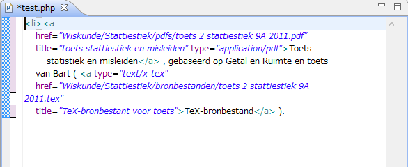

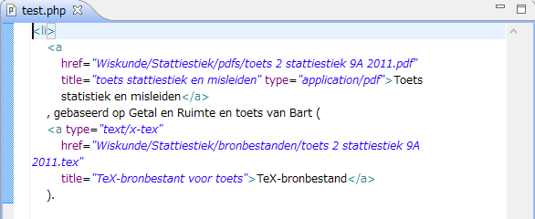

The only case I can reproduce such a formatting is...
Preferences->Web->HTML Files->Editor, remove all 'Inline Elements'.
Before:
index.php/fa/16956/0/
After - by default:
index.php/fa/16957/0/
After - configuring preferences:
index.php/fa/16958/0/
[Updated on: Fri, 06 December 2013 20:35] by Moderator
