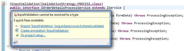

Hi Bertin,
I have a doubt because when I add
@InputValidation(IValidationStrategy.PROCESS.class)
my Eclipse IDE show an error and ask me what I want to do (see image below)
index.php/fa/17104/0/
What is the right choice?
If I choose the first, that add the import, the error remain and say me
Class<PROCESS> cannot be resolved to a type
What am I missing?
The second ask me to create annotation, but onestly I don't know what I need to do.
I didn't try the third.
Can you help me to understand what is the correct way to exit from this doubt?
Thanks in advance for your help
  • Attachment: Immagine.png
    (Size: 24.64KB, Downloaded 511 times)
Re: Legacy security hint for [message #1225620 is a reply to message #1222396] Mon, 30 December 2013 05:06 Go to previous messageGo to next message
Hi Marco,
Your code is correct. You are just missing the required imports.
So to add all imports try to press ctrl+shift+o or use the context menu in the java editor having your interface file open: Source -> Organize Imports.
This should add the following import statements to your java file:
import org.eclipse.scout.rt.shared.validate.IValidationStrategy;
import org.eclipse.scout.rt.shared.validate.InputValidation;
Does this help?
matthias
