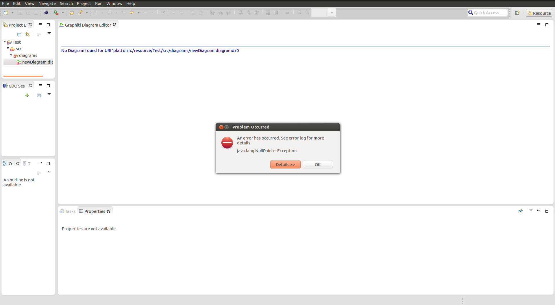

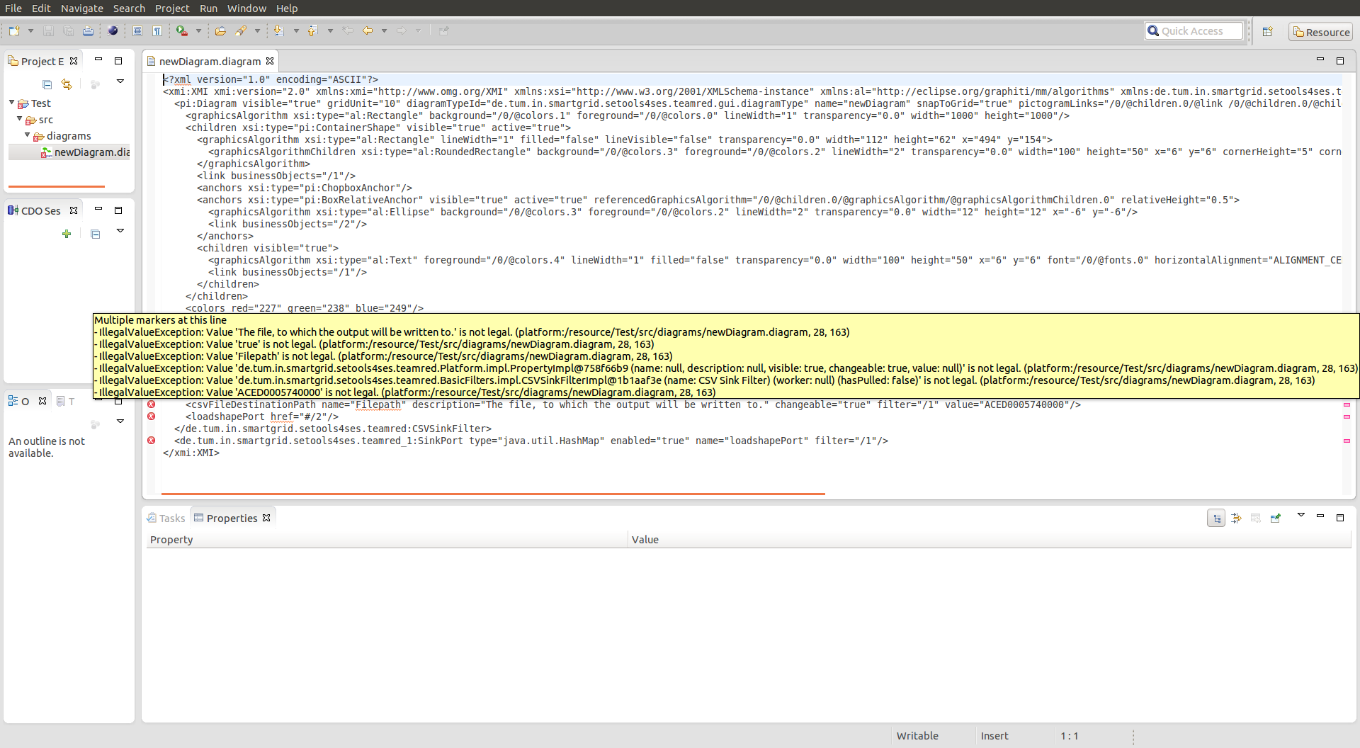

The Graphiti Diagram Editor simply can't open the .diagram file anymore. The error shown in attachment "Java - Eclipse _017.png" occurs. When I look at the .diagram file in the default text editor the error shown in attachment "Java - Eclipse _018.png" is displayed.

Do you have a stack trace for the NPE?
