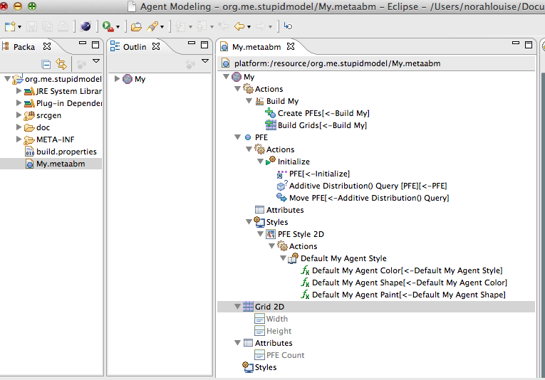

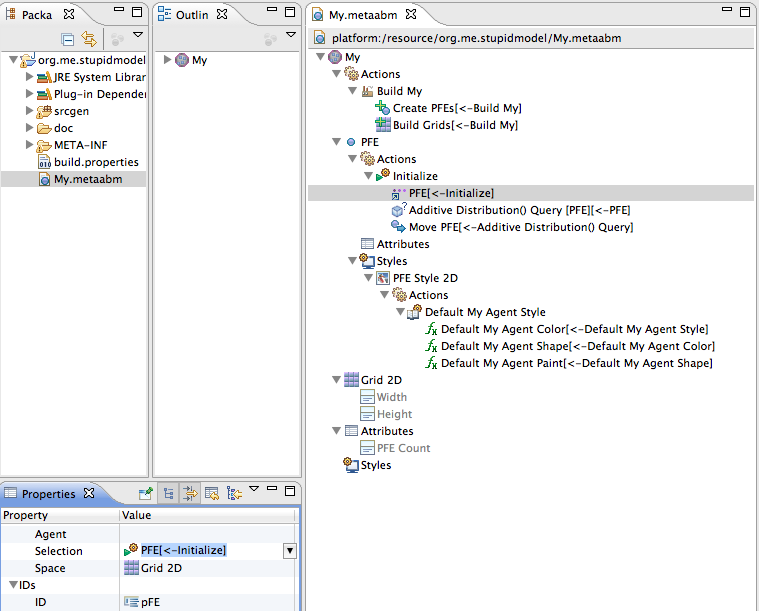

I have been trying to use Eclipse AMP by following the tutorial but I 'm facing two problems:
I'm not able to execute the program, I have a msg error that says me : could not read class
And I don't have the grid dimensions and the FOR in the agent initialize.
I'm using INDIGO Then I can't install the AMP platform from Helios (error message)
Thank you
  • Attachment: ECLIPSE AMB 1.png
    (Size: 110.21KB, Downloaded 397 times)
  • Attachment: AMB 2.png
    (Size: 100.52KB, Downloaded 408 times)

Hello Norah,
you can set the Grid2D Width and Height just selecting the Grid's attribute Width, and typing in the Properties View, a value for the Default Value property. Same thing for the Height.
AMP runs pretty good in Indigo, what do you need from Helios?
Cheers,
Francesco
P.S.
If you want to run AMP in latest Eclipse releases this is a guide that shows you how to do it from source code.
dropbox.com/s/awcztr2ndr82vik/AMPBuildFromSourceGuide.pdf
