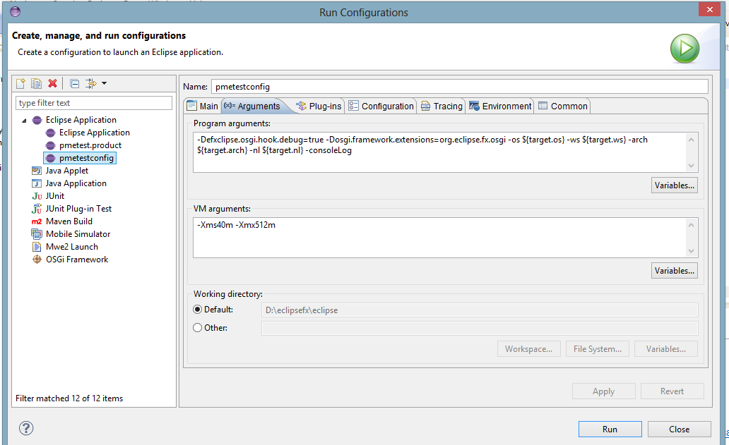

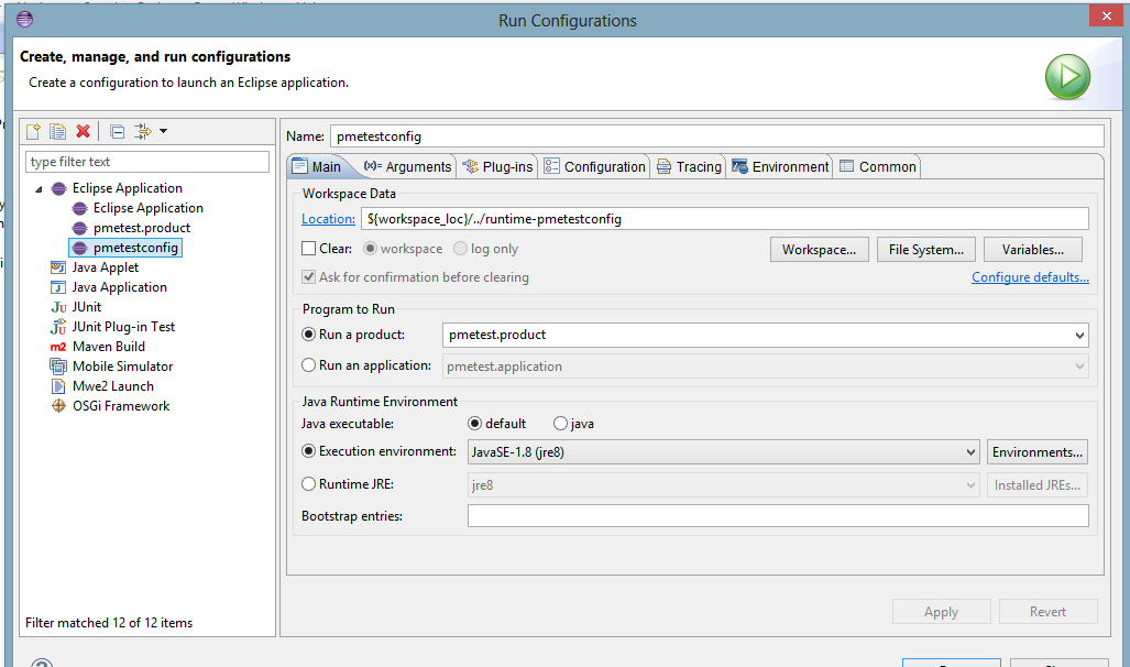

Re: org.eclipse.e4.core.di.InjectionException error [message #1217480 is a reply to message #1217086] Thu, 28 November 2013 18:29 Go to previous messageGo to next message
Thanks for the reply.
I did what you ask me to do and now this is the new error

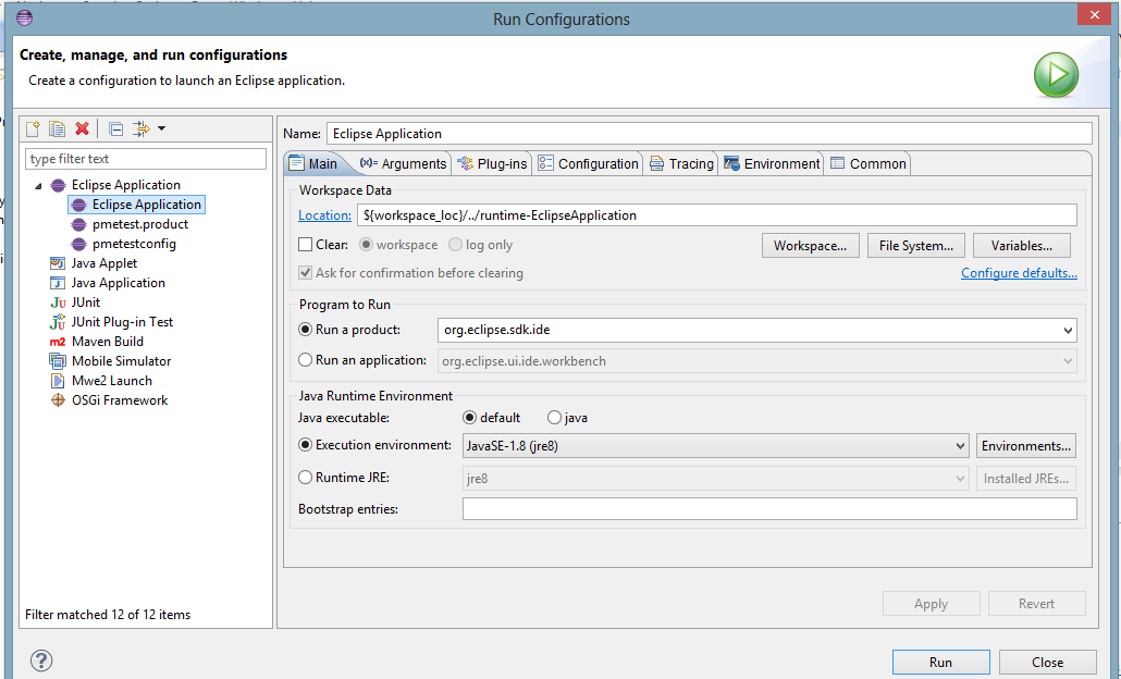

I tried what you ask me without any succes. May be I didn't make it well.
When I use the configuration like picture forum2.png the application run well.
index.php/fa/19254/0/
But even with your suggestion, the configuration forum0 and forum1(two tabs of the same configuration) I have the same error.
index.php/fa/19255/0/
index.php/fa/19256/0/
May I didn't do it like you want?

Re: org.eclipse.e4.core.di.InjectionException error [message #1431050 is a reply to message #1430910] Thu, 25 September 2014 02:39 Go to previous messageGo to next message
-D parameters go into VM-arguments and NOT into Program arguments!
Tom

Re: org.eclipse.e4.core.di.InjectionException error [message #1472435 is a reply to message #1431050] Thu, 13 November 2014 16:54 Go to previous message
Oups!! Sorry for all this time. It's ok for me now.
